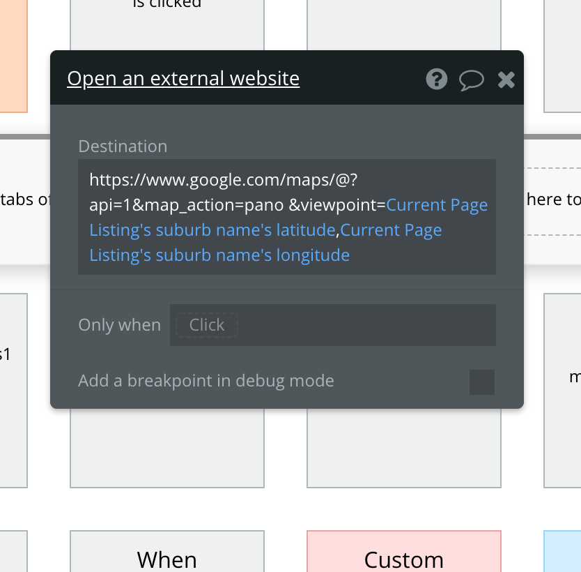

There are several ways to do this. Here’s the idea.
OK so the first thing you need to do is have the latitude and longitude of the location you are looking to create a link for. If you have the address saved in bubble as a geographical location it will automatically include the lat long. This can be data saved in your database.
Then you can create a workflow to open an external link. Here is what the dynamic link may look like:
Screen Shot 2020-07-23 at 11.41.34 PM
The text in white is the part of the link that never changes. The text in blue is the text of the link that changes based on info in my database.

thank you for your assistance, does it look like this?
Hi @ralphlasry, this worked like a charm thank you so much, only thing i need the streetview picture to happen inside bubble without redirecting to google.
