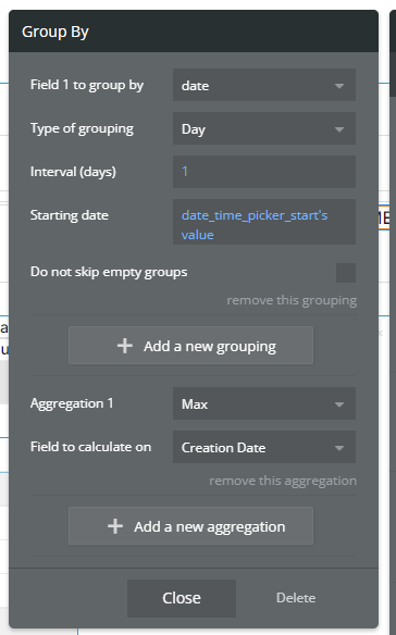

I have been able to use Grouped By to group the data by day and aggregating by Created Date MAX to get the last row of the day:
The issue I am having, though, is how to access the Total Sales and Average Sales data from the last row to use in the expression. We have tried running an Aggregation on these fields using MAX. However, the MAX value isn’t always the last value, so it doesn’t work in this situation.

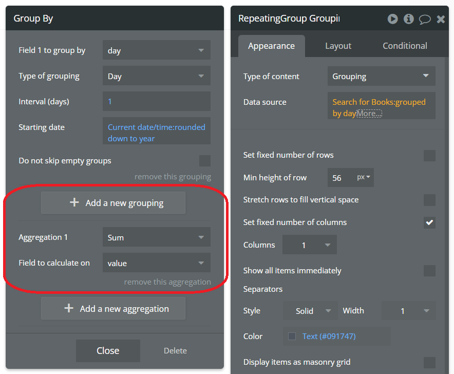

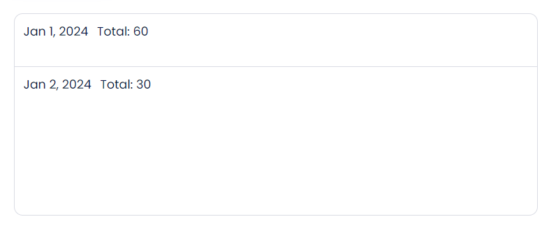

@twofatthumbs, see george’s response above. You are using a group, I was using a repeating group. The question is, do you want to show a list of days with a total per day, if so, use a repeating group, see the images below. Otherwise what George wrote.
In the editor it looks like this:
