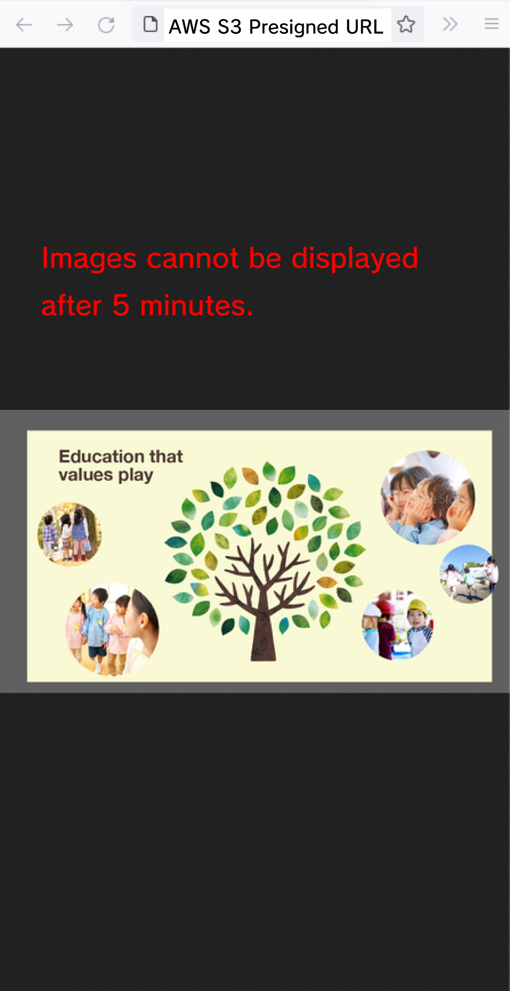

I’m trying to implement a feature like the attached image.
I want to display the image for 5 minutes after the user presses the download button.

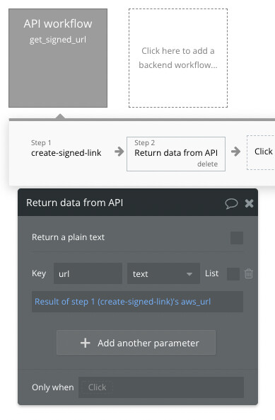

  2. Create a Backend Workflow and add the action from your plugin to that workflow. In your case your workflow will need a parameter to receive the key for the asset you want to retrieve.
  3. Every time you call that workflow you’ll generate a pre-signed link. It’s up to you whether you save that to the database for use on the front end, or you can do what I do and return it to front-end as below. For this approach you’ll need to setup a call to the endpoint from your API Connector otherwise you won’t be able to receive the return value back from the call.
