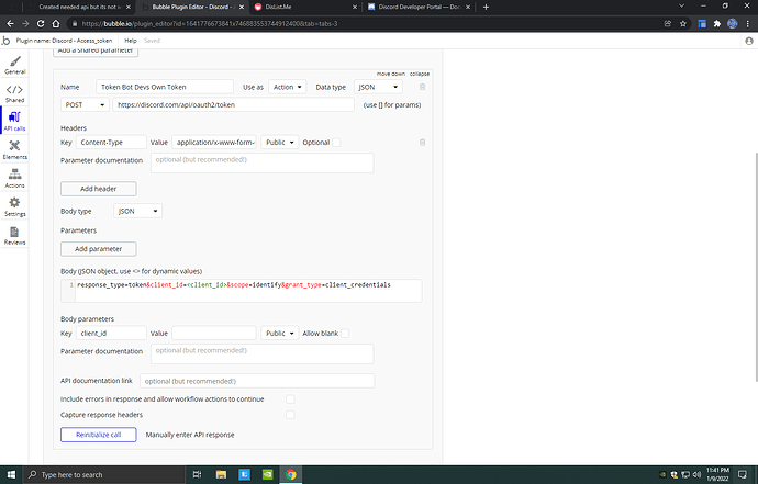

You have set the type to client credentials, but this oAuth2 process doesn’t accept code. You probably doesn’t have the correct type (normally it’s authorization_code and sometimes it’s just code).
im confused then as why my plugin works but on bubble it does not @Jici
the code part you are speaking of is returned via the oauth2 redirect… i got that the code but the exchange wont work inside of bubble only plugin
thank you again for attempting to help me it means alot its been a few days ive been on this issue

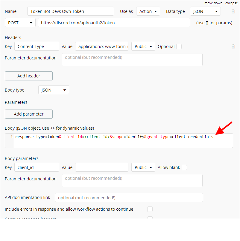

Yes, but in the plugin, you have selected client_credentials for the type. This is nt compatible with the authorization_code from the redirect.

Actually, you have set an HTTP Basic auth. This is not the case.
You have two options: oAuth2 User Grant flow or none.
If none, you will do each step manually. Use a link to the authorize url, use Get data from page url with the Code and process the code into api Token endpoint.
You cannot ask bubble to handle the auth and try to do it manually in your calls after.

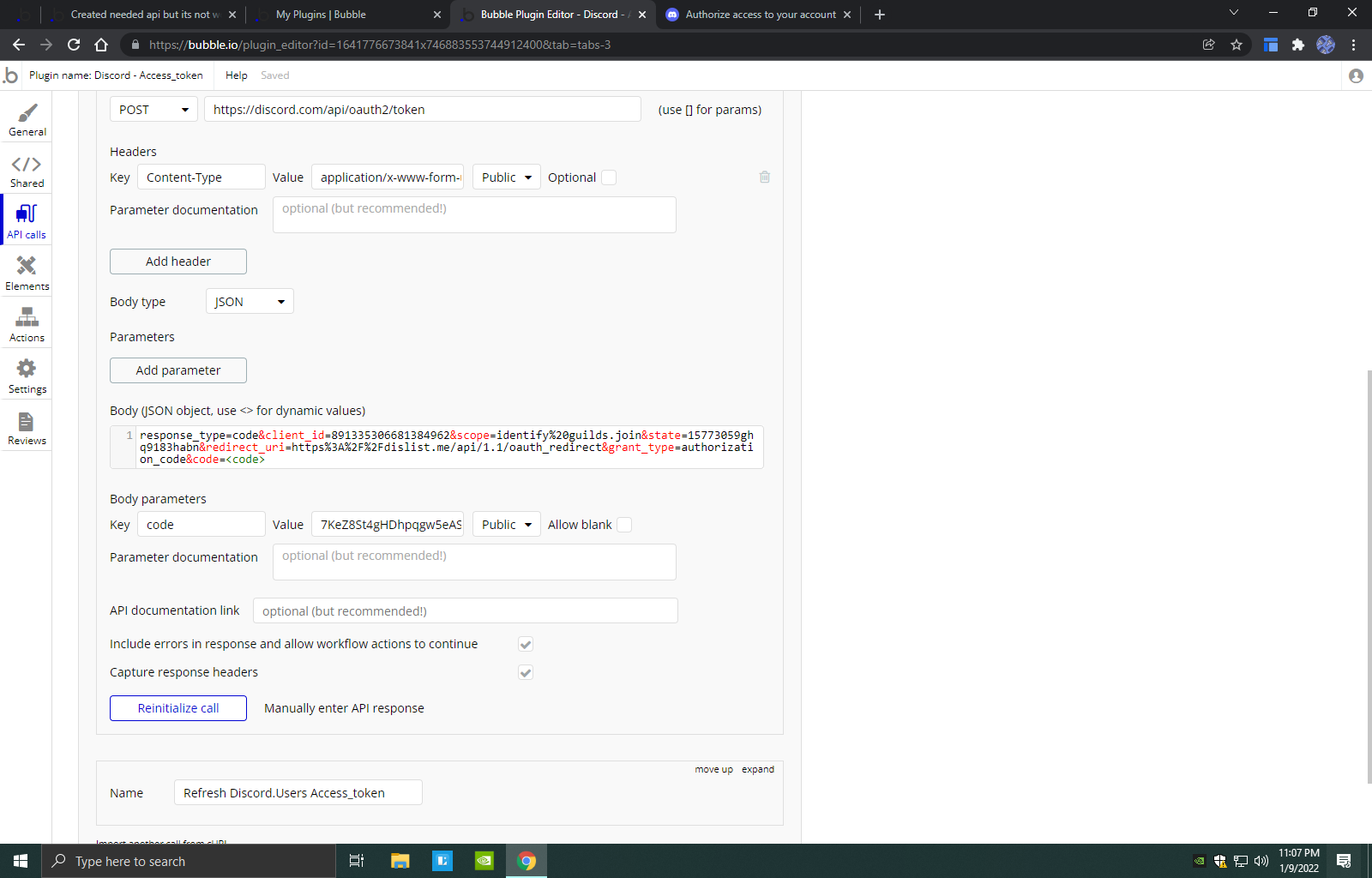

https://discord.com/api/oauth2/token?response_type=code&client_id=891335306681384962&scope=identify%20guilds.join&state=15773059ghq9183habn&redirect_uri=https%3A%2F%2Fdislist.me/api/1.1/oauth_redirect&grant_type=authorization_code&code=<code>
the user is logged in but i cant exchange the access code for token or figure out how to get the access_token ive tried via saving to user saving to web storage and more but i cant seem to get this to work if need be if you like i can spin up a new testing discord account for you if you do not have one (call it a dummy account more or less lol)

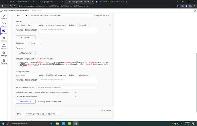

but yet when i use a action or even set my plugin for the code exchange to attempt to get access_token it wont go threw always error wrong code but its the same code i would of used to even autheticate the plugin its self of course not same exact code as it changes and expires in a short time but not short enought i cant run a api or use it to thus later add user to the server after but i can not do this with out the above so i hope these things help explaining more

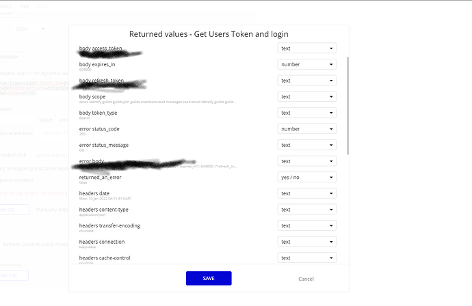

The api call for this aspect for the code to get token is as such
http basic auth which is suppose to be used from what I’m being told from reading the documentation over at discord - which works btw look below i was provided my token and refresh token as well
