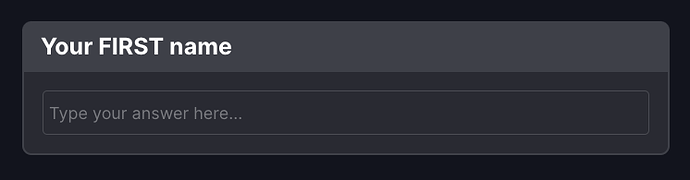

For whatever it’s worth, this is what a “question 1” group looks like:
