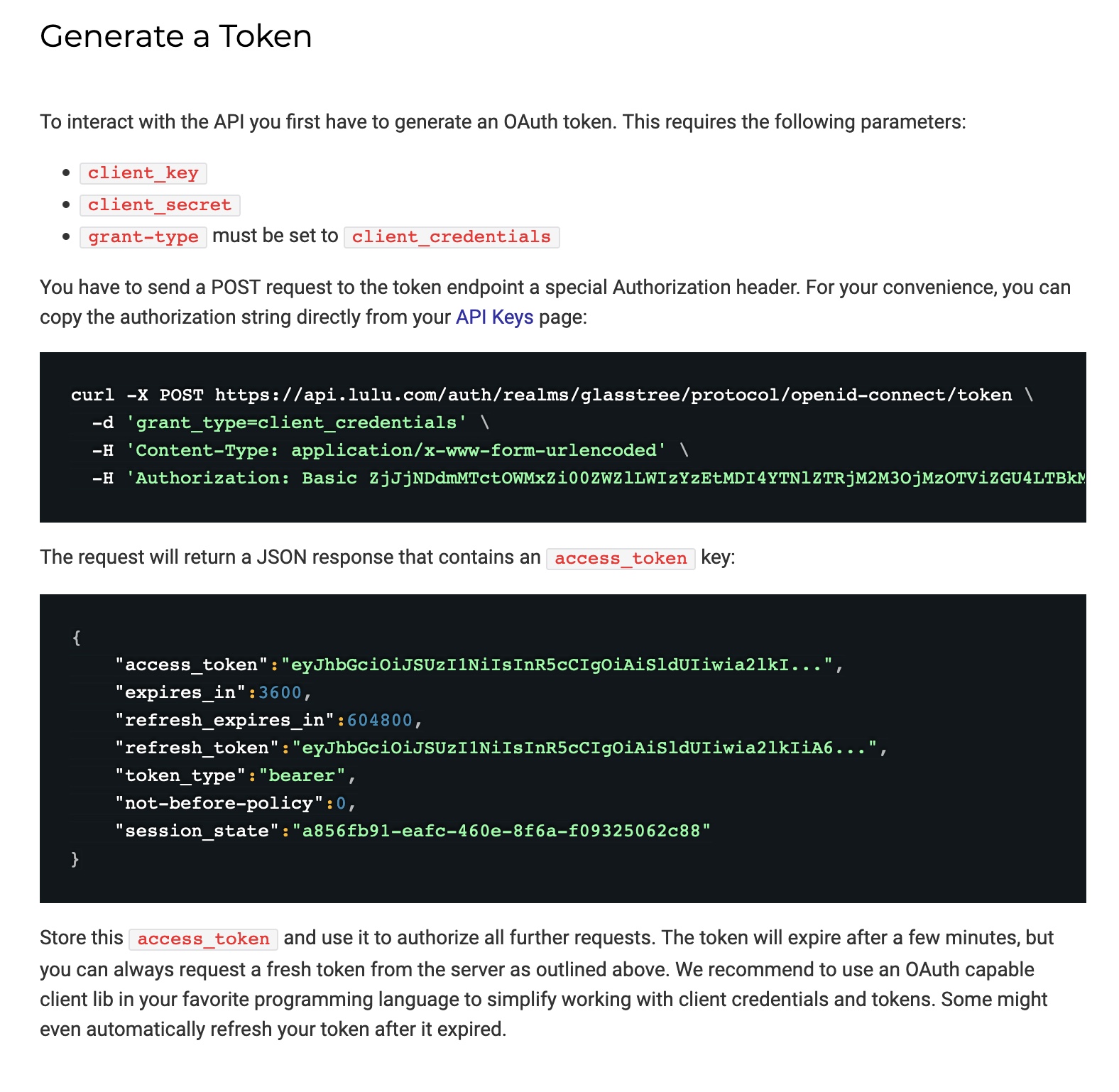

Hello everyone,
Is anyone able to help out a bit on how to set up the API connector in order to connect to this API from lulu.com
I’m kind of stuck in the first part on how to generate the token.
Here is what documentation says:
Any Ideas how to set this up, I have tried many approaches with different settings but I can’t get it to work. I usually get an error saying something like “Missing form parameter: grant_type” etc.
What are you exactly having issues with? The missing form might be because you haven’t added the Content-Type header
This is client credentials. So you need to use oAuth2 Custom token
This will look like that:
Put the url into the Token endpoint (POST)
in body:
client_id=your_client_key&client_secret=your_client_secret&grant_type=client_credentials
Set two Token call header (be aware to not put them in the shared headers for all call)
Content-Type: application/x-www-form-urlencoded
Authorization: Basic Your clientkey:clientsecret encoded in base64
