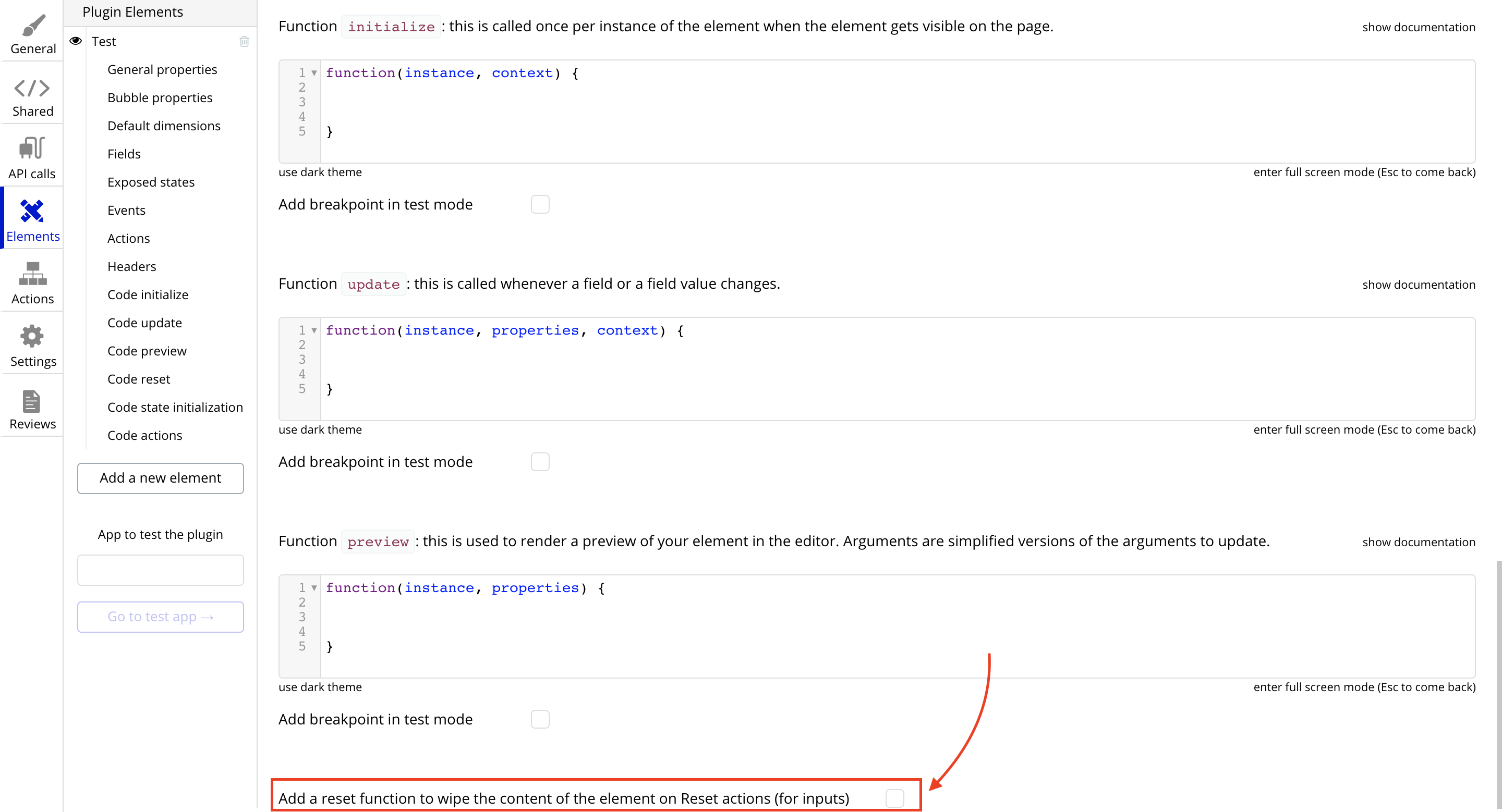

Glad you are getting it to work for you. Is there a reset workflow that you can use?
If not, I think I had to refresh the page after each scan. I would try asking the plugin creator if they can put a reset workflow into the plugin. I think it might be as easy as a checkbox. I really don’t know though. :man_shrugging:
Not sure if this checkbox would do it or if there needs to be some added code in the plugin, I really haven’t built plugins yet. :blush:
