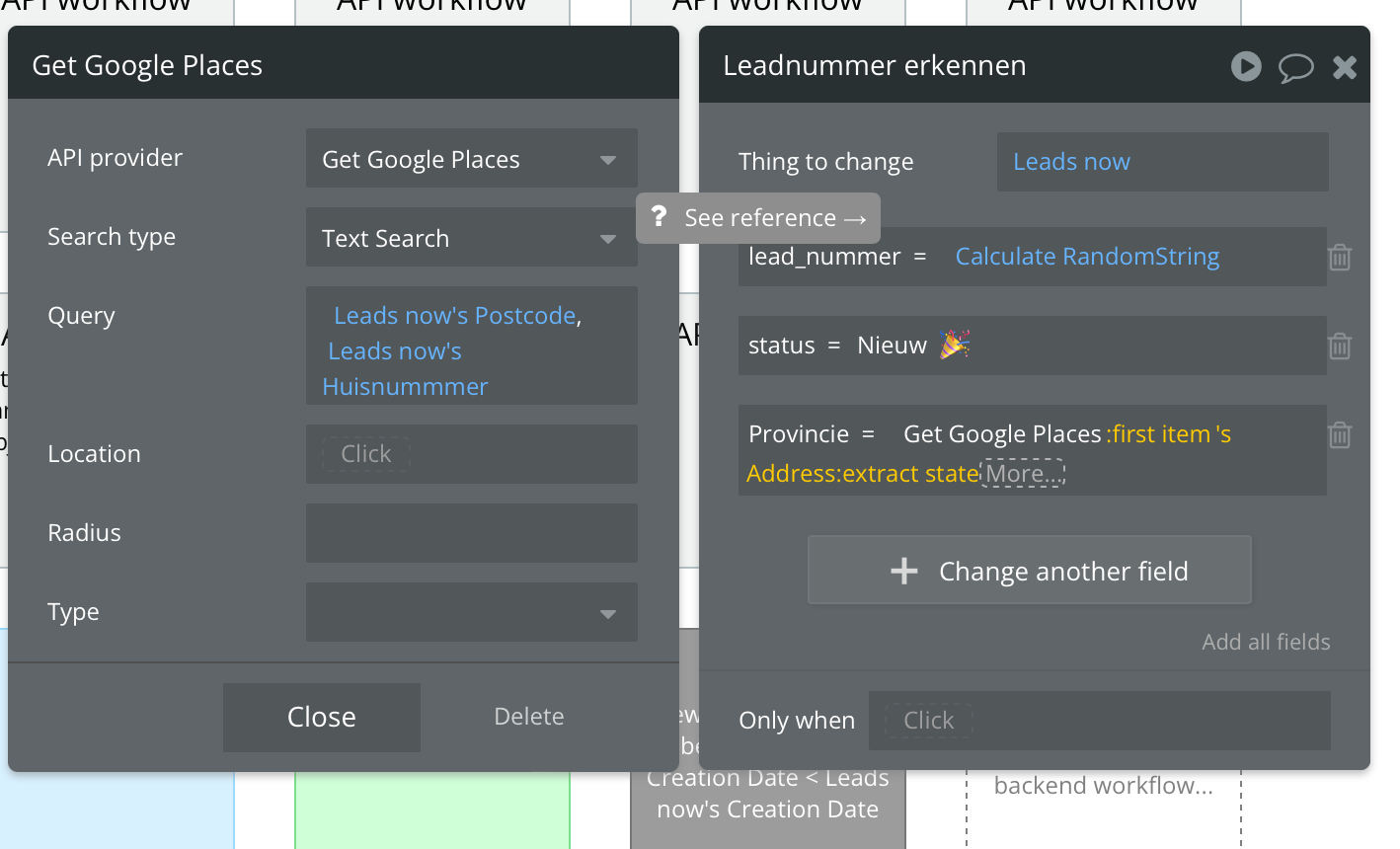

Ah, i see. I get the address. I also need the state from that adres but I can’t find a way to extract it from the address (only on a normal searchcbox). Any idea for this?
Ah, I get it now. But the response is stil empty, this is my setup now:
Any idea how I can fix this @boston85719?
Add the location, radius and the type
The type i can only select companie industries e.a.g accounting?
