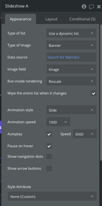

I have an image slider plugin (slick slideshow) I’m using to display a list images. The user can slide left or right. I need to show the image number of the current image in the bottom right. Does anyone know how to change the custom state number when an image is slid left or right? I simply want to minus one or plus one to the number based on which way the image is slid.

Than you select the datasource of the slider do a search for banner.
In the page where the banner is exposed you insert a text showing the current slide number.

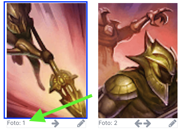

Instead of drag and drop change this picture order to simple arrows left and right and use the following WF.
You will need a WF to the right and another one to the left and both has to be in 3 steps.

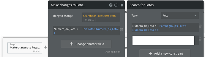

To the right => Step 1 search for parent group picture + 1 and change the number of this picture to this picture number - 1

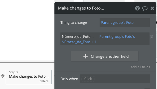

Step 3 change the parent group picture number +1
Now you will be able to display the correct numbers of the slideshow.
