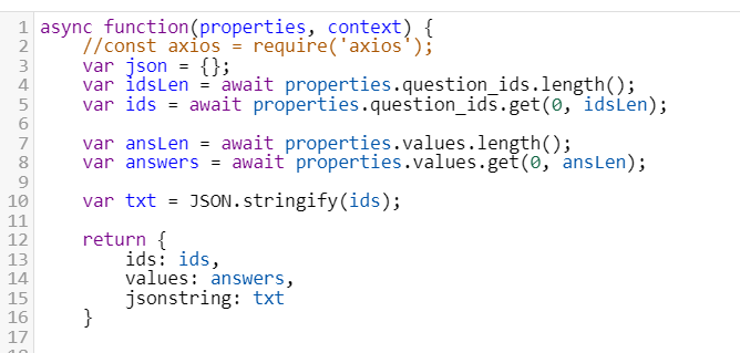

I’m building an SSA where a list of texts is passed. I’m then trying to find the index of a particular value in that list. To do that, I have the following code:
So ids and answers are the lists, but let’s just focus on ids.
Then I run the following to get the index of a certain id (which I have triple check IS there):
json["Tag"] = ids.indexOf("1631478754886x312173621329264640");
This returns a -1, meaning no matches are found. I discovered this is because indexOf does an exact match search, and the get function that’s available for getting the values from the List object that’s passed through returns an array of objects.
How do I just get a straightforward array of values that I can work with and use functions like indexOf on?

That’s what I thought, but that’s not what’s happening for me. Take a look at this code:
I would expect that txt would simply be something like ['value one', 'value two', 'value three']

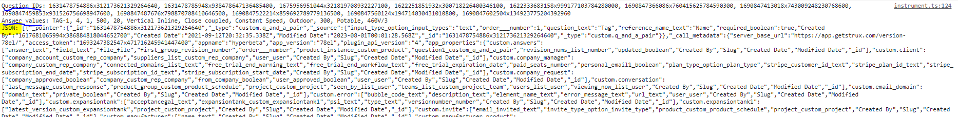

But it’s not. When I return it and log it directly to the console on the front end, this is what I get:
It’s a bunch of gobbledygook. Oddly, Simply returning ids and answers works fine.
The only thing I can think of is that when var txt is set the ids promise hasn’t resolved yet? Thought I’m not sure why that would be as I’m using await and running inside an async function…
Any ideas?

I just tried with a list of unique ids, and I get the same behavior. You can even check with context.isBubbleThing(ids[0]) and you will see that it is indeed a bubble object instead of a string (I tried with a list of users’ ids).
You may have found a bug, or maybe an “expected behavior”
