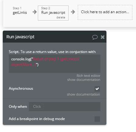

For example, here is a screenshot of me trying to use Run javascript to simply “console.log()” the object, which in a browser or a Node JS script, just works.
The issue is that the object is not text, which of course it isn’t.
For what it’s worth, Bubble did create an object property named “raw body text” that I did not define, and I tried it, but it seems to be always empty.
