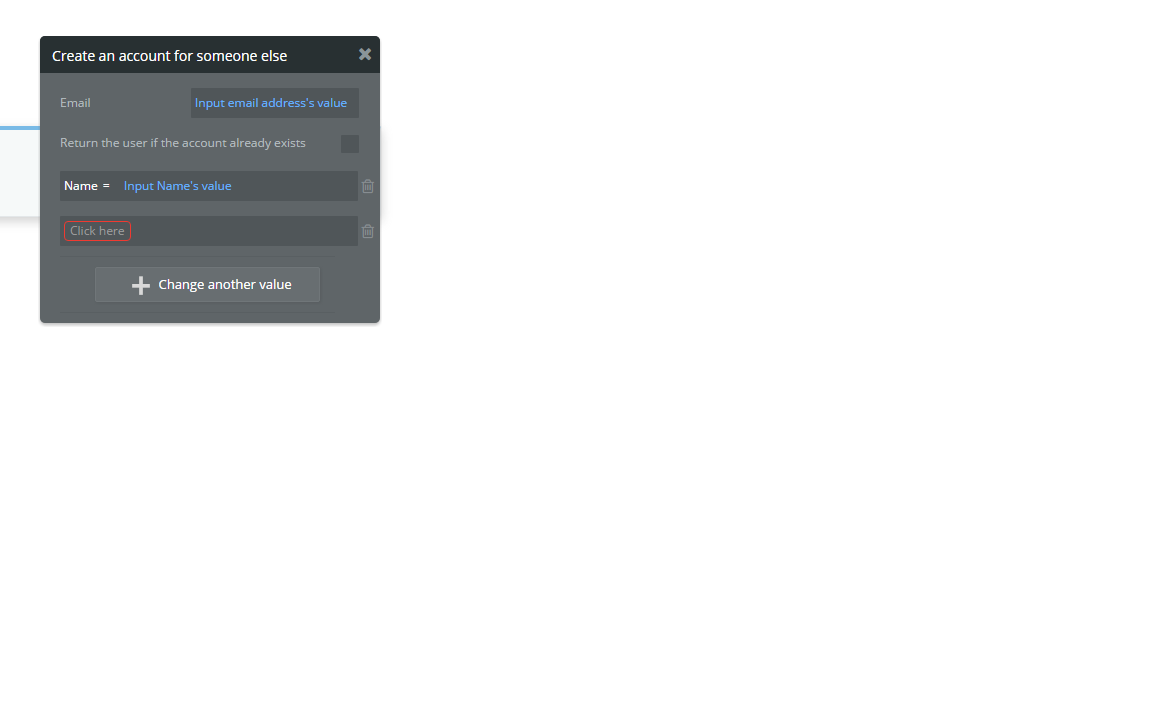

I’ve created a page where I (= admin) can sign up users with their name and email address. As someone already mentioned above, there’s no way for me to set a password at this stage. That’s why I used the action called ‘assign a temporary password to a user’ but I don’t know where to get this temporary password from. Where would I find it?
Then I want to manually send the newly created user a message with a link to the website where they will be able to set their own password and log in. How would I do this?
PS: I already set a page for users to be redirected to when their password isn’t confirmed. But as far as I understand that only works if there’s already a password set for them.
