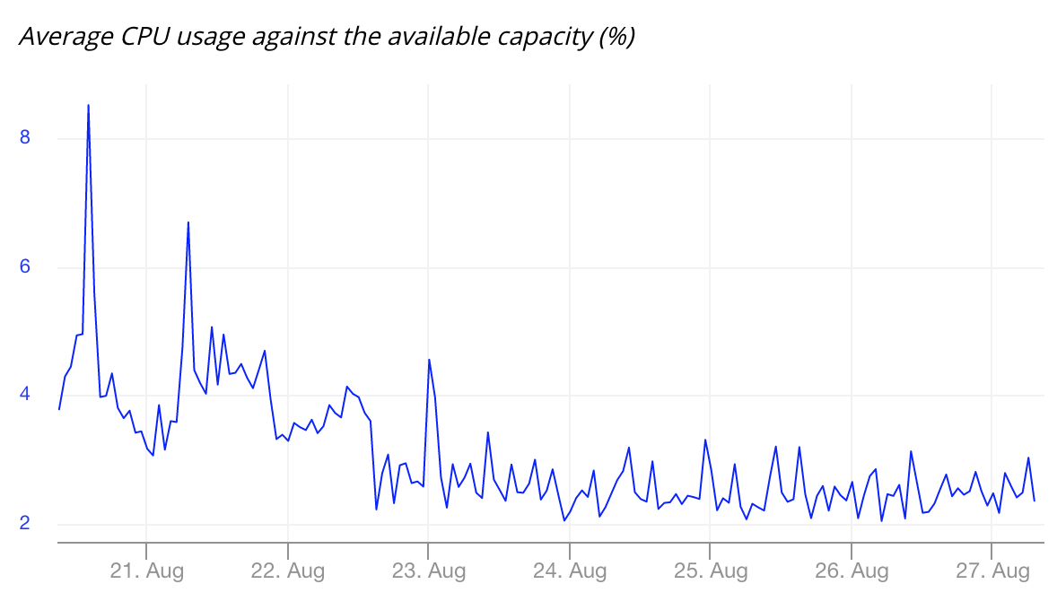

I have an app on the personal (legacy) plan, which is essentially a marketing website (with no workflow runs). I’m not getting 100 concurrent page views, but the data below might help.
If I look at large timeframes it seems to handle the traffic without any problem.
7-day view:
Going down to the smallest available timeframe, it looks like a rule a thumb would be 1 page view = 0.5 to 2.0% of capacity.

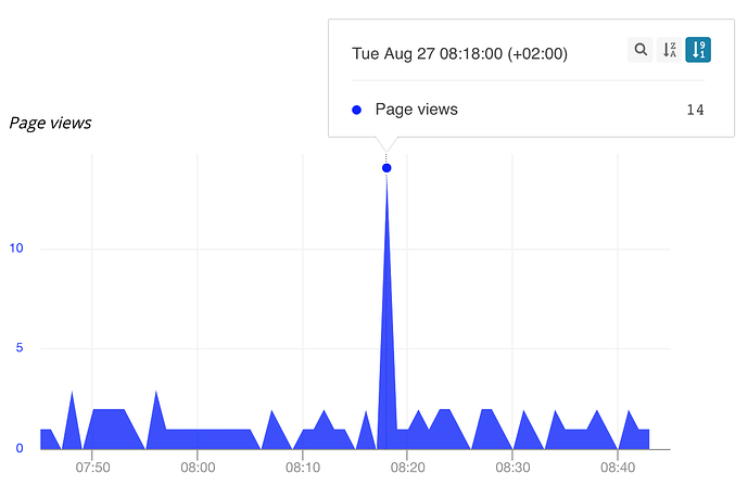

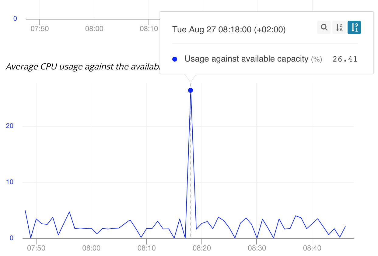

1-hour view:
Hope that helps :slight_smile:

Super helpful! Thank you. It does worry me that with 14 page views in a minute CPU usage was already at almost 30% but hopefully the page won’t be too slow!
It will slow down, and workflows will begin to fail - in my experience. Supposedly they say they watch for this and will help offset sudden spikes like this but I don’t know if that really happens.
