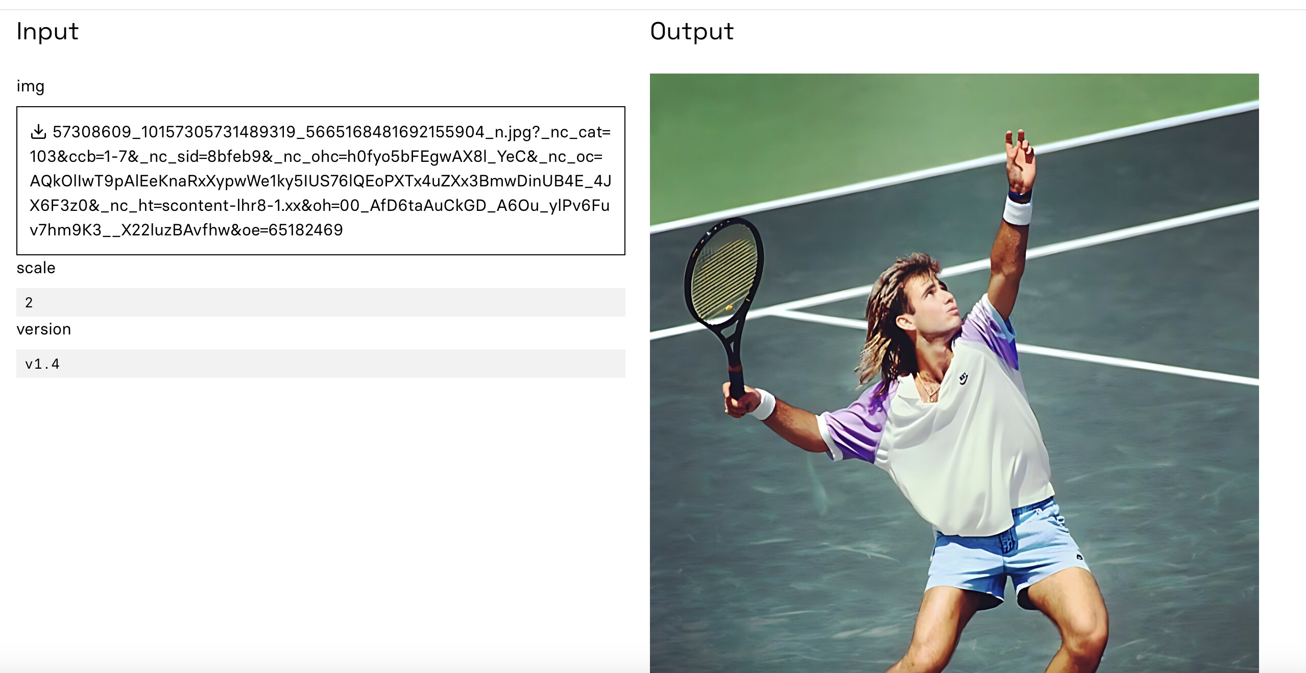

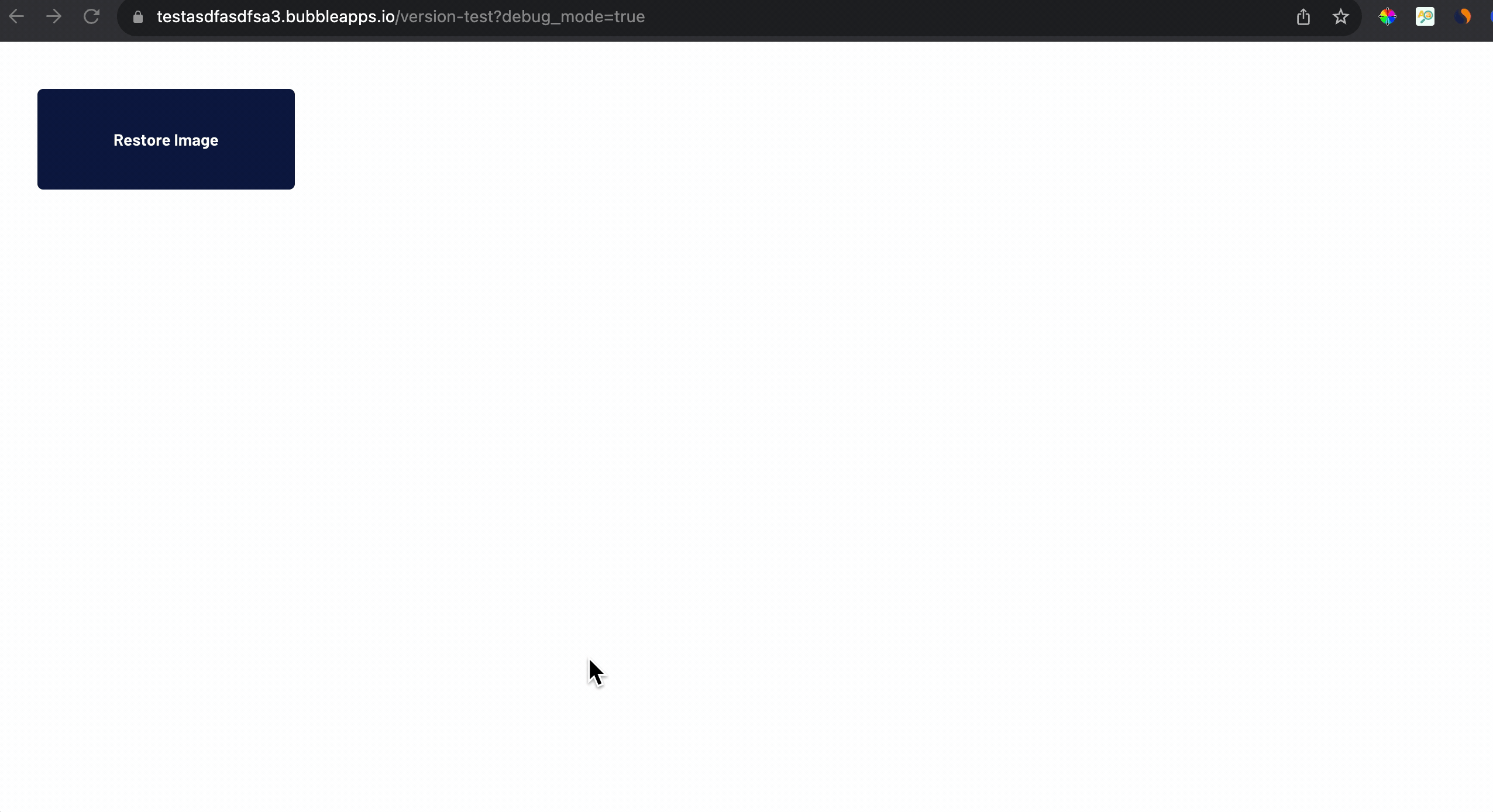

You’ll notice the “img” input is the actual URL of an image. This works fine. When I run the action in my test app…
2023-08-31 17.01.08
…the prediction gets processed in Replicate. This is the output, which I’m very happy with:
