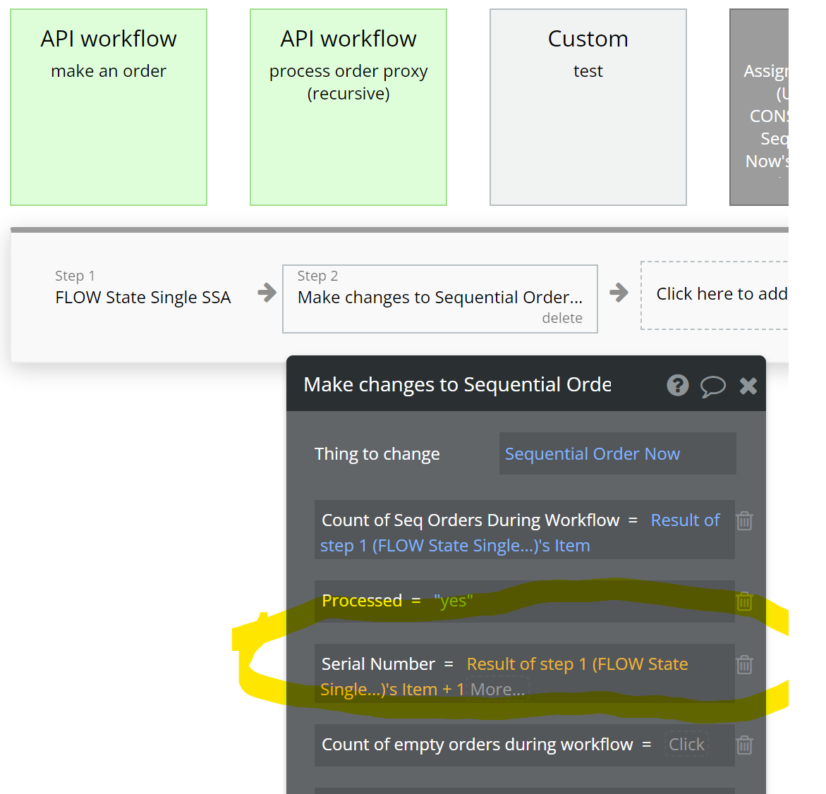

We can instead use the Flow State Single SSA (server-side action) from my List Popper and Friends plugin to get Search for Whatever's (with Created Date <= This Whatever's Creation Date) :count. Like so:
What this does is evaluates the current count of orders immediately and returns that result to the plugin’s “Item” output. Since this never gets re-evaluated, there’s no way for that count (present at the Item output) to change during the workflow. So this accomplishes exactly the same thing as :make static in the vanilla Bubble solution.
And then our Make changes step looks like this (result of step 1 + 1):
Note that if you do this, the FLOW State Single step should be the very first step in the workflow, regardless of what your workflow needs to do later.
So, we never have to do :make static (which seems to use a lot of resources, etc.) and we’re just using the :count result of a Search… which is a less resource intensive sort of expression (at least as far as I can tell).
