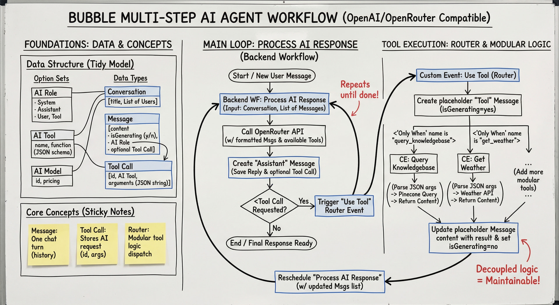

Logic overview
  1. Process AI Response (backend workflow) Input: Conversation, List of Messages
  • Call OpenRouter (or OpenAI) with messages, and the available tools.
  • You’ll need to :format as text your messages and make sure you handle edge cases appropriately.
  • If This Message’s Tool Call is not empty (meaning the AI requested a tool in this message), then we need to pass that tool call’s ID/name/arguments into this part of the prompt (docs here, and here).
  • Save the model’s reply into a new assistant message.
  • If reply includes a tool call → trigger Use Tool custom event; else stop.
  1. Use Tool (custom event)
  • Create a tool message (isGenerating = yes) so users see ā€œthinkingā€¦ā€ or whatever you want in the front-end.
  • Use ā€˜only when’ conditions to make sure we only run the custom event for this tool name.
  1. Per-tool custom event — Example: Query Knowledgebase
  • Call your own backend workflow with arguments to convert the string into useable JSON.
  • Do whatever logic you want (e.g. get embeddings and query Pinecone).
  • Return content from the custom event so it can be accessed from Use Tool custom event.
  1. Use Tool (continued)
  • Fill in the previously created message’s content with the returned data from the custom event that ran, and set isGenerating = no.
  • Reschedule Process AI Response and pass the updated messages list (as the AI needs to respond again now it has the tool result).
  • Loop repeats until no tool is requested.

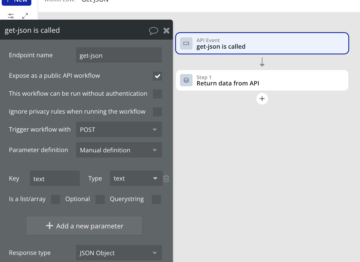

We pass the OpenAI response’s tool call arguments (the JSON) to the custom event:
Have a public backend workflow called ā€˜Get JSON’. This takes a ā€˜text’ parameter and has a single action, Return data from API. It returns, as application/json, the text we provided.
If I provide {"query": "latest news"} to this API call, it will return it as useable JSON. This is necessary because OpenAI returns the JSON function call as a string, not as a JSON object that can be detected from the API connector.

Nano Banana improved my diagram
