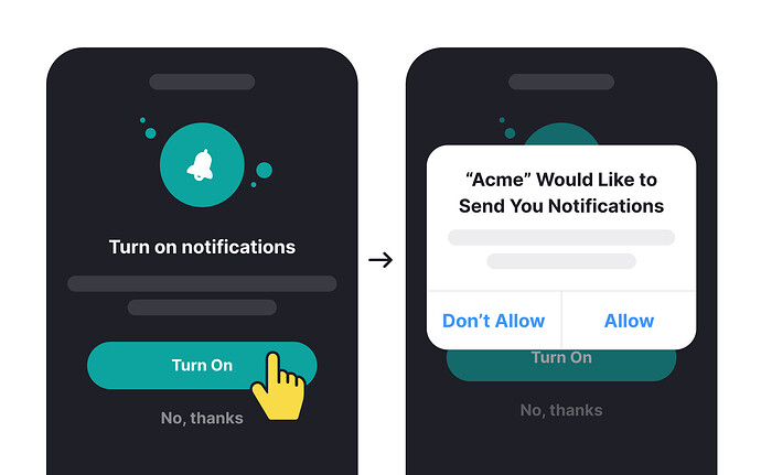

How can I check if a device has activated push notifications ?
When users reach a certain view in my app, I’d like to check if their device has already accepted push notifications, and then, if no, show a sheet to pre-prompt them before running the “request push notification permission” action.
Is this possible ? I’m trying to achieve this :
For location services, there is the expression “has granted location permission”
How can we accomplish the same thing for notifications?
I’ve played around with expressions starting with “current user device’s” or “do a search for devices (current user = current user” but no success
