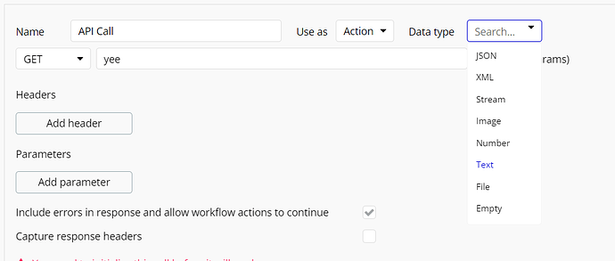

first set up the return as text

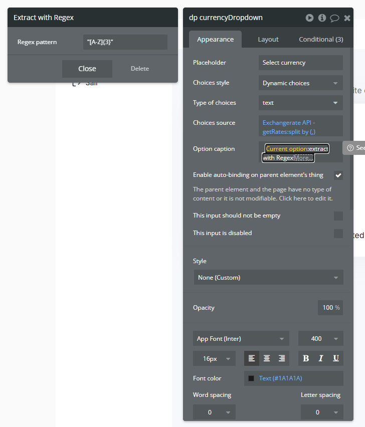

Then use regex extract to extract
“conversion_rates”: {
“USD”: 1,
“AED”: 3.6725,
Regex: "conversion_rates"\s*:\s*\{[^}]*\}
Then set up the json just like the one in the editor, your dropdown then works
afterwards, to convert the text to list, there might be a way, but the easiest method might be javascript
but storing it as json works just fine

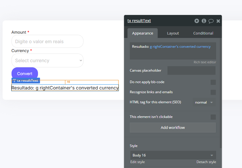

So it appeared like this (as in the photo below). Using it as text, can I show the currency conversion?
Show the currency conversion where?
Here.
I had the idea of storing the result in a custom state called “converted currency”, which is of type text. My plan is that when the user clicks the “Convert” button, it will trigger the API call, and then the result will be saved into that custom state.
And here is how I’m trying to put the value in the custom state (I don’t know if it’s the best way, but that’s what I thought)
If it works, then why not
