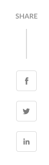

I am looking to create a floating visual element (social share) that scrolls with the page as a user reads through the article. You can see a visual example of this happening here.
Any suggestions or advice on how to accomplish this would be amazing. Thanks!
Screen Shot 2020-12-10 at 5.11.05 PM

Take a look at the grey slider on the right side. It’s done with a drag/drop group and JavaScript.

@jj11 - its not too much JS to get started with this. First thing that I would is that you build the component that will be on the side of the page that scrolls. I did it the following way:
Floating group - I set mine to 550px high (make note of height as you will need this)
Shape 1 - this is the line showing the progress, make it 500px height and no more than 4px wide
Drag/drop group - this is clear and sits inside the floating group, constrain to parent and disable the ability to drag.
Shape 2 - this is the part that moves. I made mine 50px high, 10px wide and rounded the edges.
