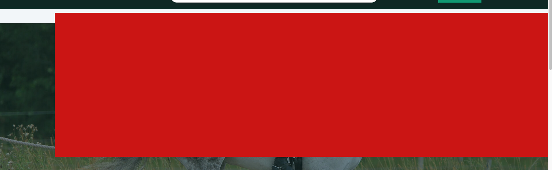

Hi Adam, screenshot attached hope this demonstrates the issue. Also included example of what I am trying to achieve.
In editor, 100% taking it over the pages width:
In preview is not within the page:
Example of mega menu structure I am trying to achieve:
What is your group focus reference element? (and have you set any offsets?)
Dropdown 1
Dropdown 1
That’s your issue then…
If you want it full width your reference element needs to be the header or the menu (not an element within it)
