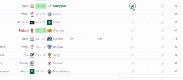

The feature is a rating system for sports matches. So the user rates the match itself and then each team, and they get a point (check out the right side of the screen) each time that they capture a rating. And then once they’ve captured all 3 ratings, they get to see the average ratings from everyone.
