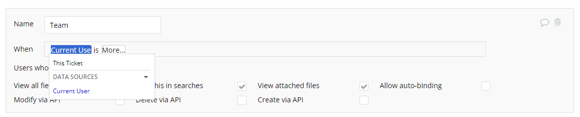

We want to setup a privacy rule where the user has to be a member of the team to which the ticket is related. So I was expecting to do: When do a search for team member where user = current user and topic = ticket’s topic >0
However, there is no do a search here. I can only make the rule directly related to the ticket or the current user.

The rule should be: When This Ticket’s Team is Current User’s Team
(if you don’t already have a Team field on the Ticket datatype, then you’ll need to add one).
A user can belong to many teams. So it’s not as simple as User’s Team = Ticket’s Team.
We have Team Member entities that are the relationship between Team and User. Then The ticket is associated to a Team/Topic.
Hence we need to find whether the User is among the Do a Search for Team Members where Team = Ticket’s Team and User is Current User.
You can’t do searches in privacy rule conditions…
Privacy rules can only relate to the current user or to the object in question.
So you need to set up your database structure to suit.
Yup, what Adam said. So, you could add a teams field (list of teams) to the User data type, and then create a rule on the Ticket data type that says when Current User's teams contains This Ticket's team.
