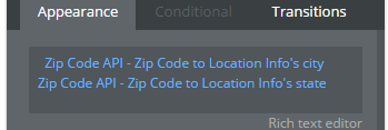

Use the “Zip Code to Location” call to retrieve city and state. Same plugin, different call selected in “get external data from API”. Use it the same way, select your input as the zip value and compose the expression to read like below:
