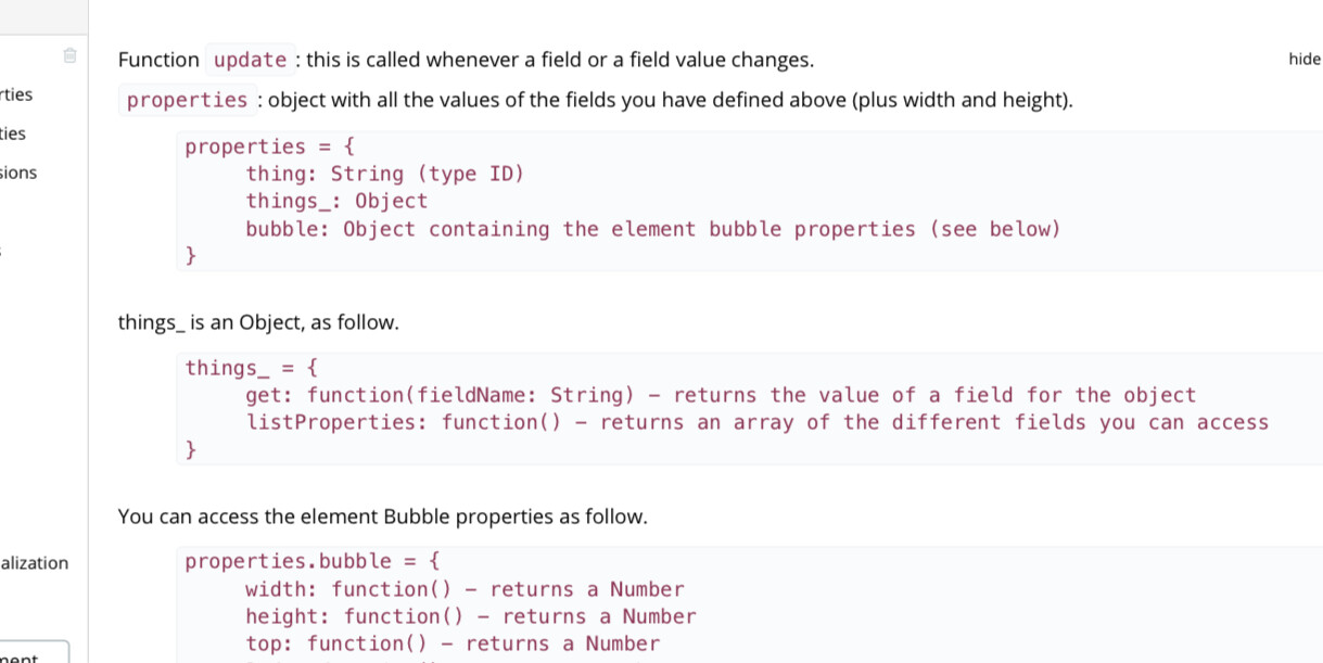

Is there a way to get a list of properties from App Type field?
For example, I have a data_source field where user can set their custom type:
I want to get all properties that this type can have, like:
properties.data_source.listProperties()

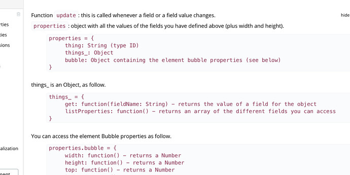

First you need to create a data tape and then a data source for your input fields as shown here
Once you have things set up like this you can get to the code and you could retrieve a list of all properties like this
//get all keys
const keyList = properties.things.listProperties()
//bring in the actual data
const allThings = properties.things.get(0, properties.things.length())
//create a Json representation of your data input
const jsonDataArray = allThings.map(x => {
    let obj = {}
    keyList.forEach(y => {
        Object.assign(obj, {
            y: x.get(y)
    return obj
@jared.gibb Oh, got it, thank you so much!
