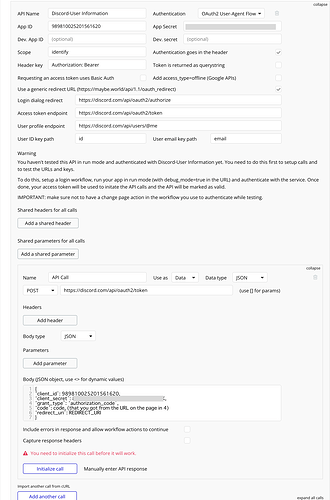

Hello @NigelG sorry for disturbing you, but regarding this matter i’ve actually been attempting just to login a user using discord api and recieve back a access_token well logging said user in
I need the access_token from the url after login i can do this with regex or another form of split i guess from reading up on another article ( Thanks To @lantzgould btw for that ) but the issue i dont actually know how todo is what you are defining here
discords api OAuth setup is found here Discord Developer Portal and I’ve made a plugin to handle OAuth logins but again I want to change it so I receive the access_token my plugin can be found here in read_only Bubble Plugin Editor - Discord - OAuth if you could help me out this would mean the world discord offers the API documentation to handle refreshing of a users access_token which i can on my own but other then that yeah I’m REALLY stuck
There is a button in the api area of a plugin on the oauth setup to call back the access_token i need this somehow working Bearer is usable and returned when requesting token

I can get the users ?code= and save it via OAuth using my plugin as is already but … when i made the token exchange plugin part of my discord api plugin above - i honestly do not know if i did it right or not.

im sorry but Jici got it working it was a pain i have a help topic on this and will be updating the fix later on free time - jici also stated he would post it in tips area here in the forum im trying to merge the gap between coders and no-coders of discord bringing even more users too bubble who are developers who want to developer just that much easier thank you again for taking the time to help! It had to be performed via a backend WF as well on a internal api call to get it running right with a custom made plugin of course
