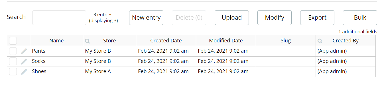

Second, you will create another type of object called “Item” and you can add a new field to this Item object, and call that field “Store”, and as a data type, you will choose a “Store”.
So whereas regular DBs would a string or integer datatype as a reference ID to another table, in Bubble you explicitly specify the type of entity you want to link.
So here’s your basic “table join”.
Furthermore, if you want to link a same item to multiple stores, you can go two ways.
  1. Create a relational table like “Inventory” where you associate a Store with an Item.
OR
  1. Tick the multiple entries in the Store reference field of your item. This will basically allow you to record multiple stores in that field as an array.
Personally I would go with option 1, it’s a lot easier down the road.
