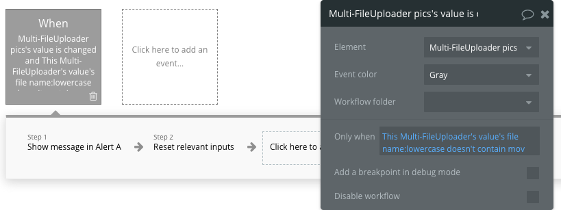

I want to limit video files so I ran it this way but when I upload photo files, I get an alert.

I tried this way like that but it doesn’t work.
スクリーンショット 2020-12-25 12.27.11
