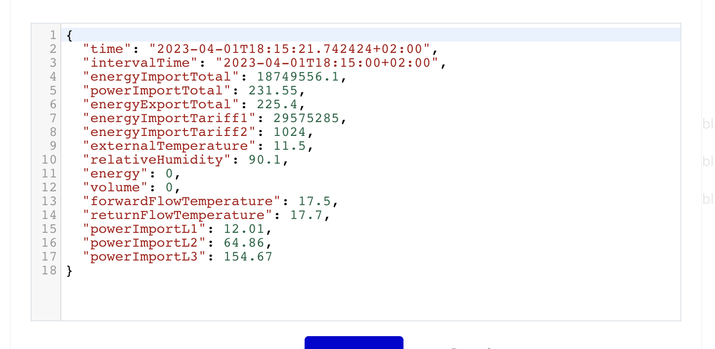

Here is the screenshot of my “manual response” Thank you so much for you help @Future

Actually, you just have to add “[” before the initial “{” and “]” after the final “}”. (everytime you’re going to edit it… because bubble doesn’t remember)
Not too sure about second question but for example… If sometimes you have a result like “energyImportTotal”: 10, and sometimes it’s not there but you have “energy”: “value”… You just make sure to include every possible options in the response editor… In your workflows, Bubble will use them if they’re in the response… and won’t do anything if its not there…
