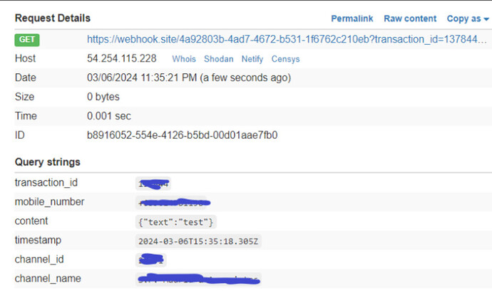

Hello, I am receiving data from a webhook.
I have my API Endpoint with GET Method
I can save the data in my database, my only problem is whenever I try to save the content, it is only saving blank data. Now, I think the problem is because the content has different format therefore bubble can’t read the data.
Bubble should be able to read it and this is a string. What did you set into your fields? We don’t see this one in screenshot. You should have set “content”… don’t try to fetch the string inside the content… this won’t work.

It will not work. According to doc, this is not sending content={“text”:“test”} but content[text]=“test”. Bubble actually doesn’t accept square bracket in the parameters name.
