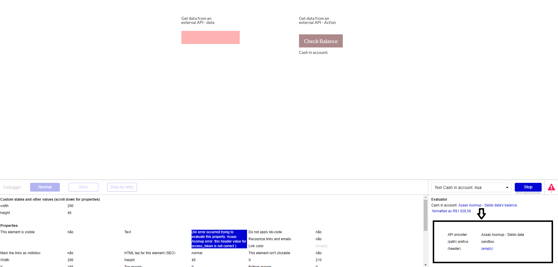

Regardless of the rule, no one should be able to see this token for the API call and this is working fine. The problem is that it only works on the backend, I want to know if there is a way to pull the data without being during an action, as in the photo below:
The “access_token” field is what contains the privacy rule, and in this case it is as if this call used an empty header (unlike what happens during the workflow, where Bubble can understand that this field is not empty, but does not show the sensitive information).

In this example, the call gives an error because the apiKey contains privacy rules:

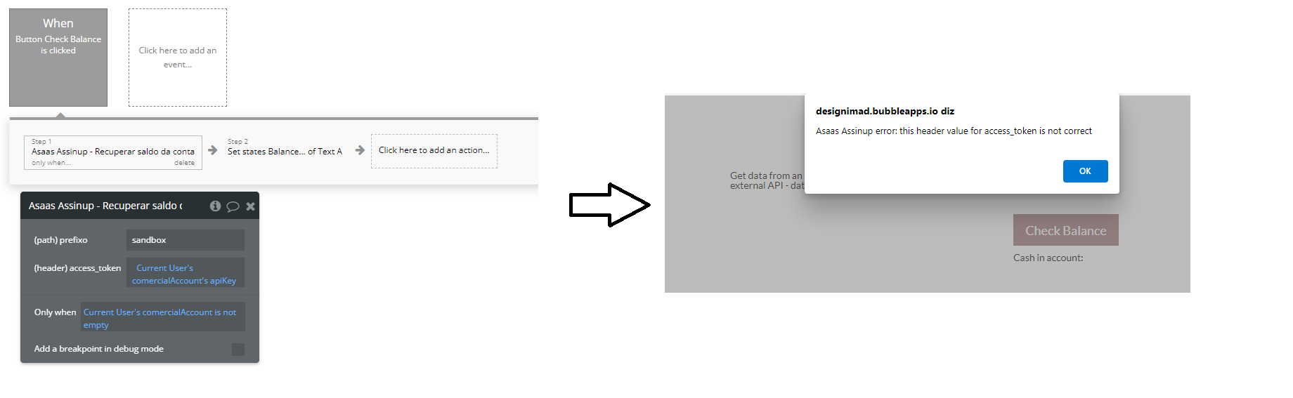

Now, in this example, the same api call, but in action form, works:
And to make matters even worse, if I put some condition in that same flow, it gives an error:
