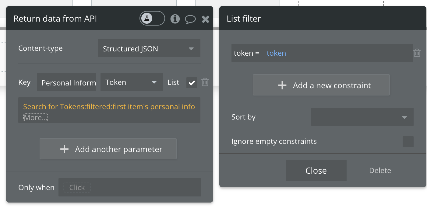

Based on your guidance, I a) change the parameter definition to manual definition, and set up a parameter called token, and defined it as text, b) I set up the ‘search for…’ and ‘filtered…’ in my operator as the screenshots shown below. Now the operator turns red and not function. Could you please give me an idea how to proceed? I think I made errors somewhere.
Thanks again!

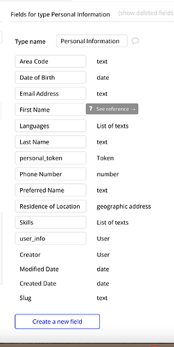

Just taking a look on my phone, will check it properly when back at the PC, but it looks correct, what are th privacy rules on those datatypes?
Thank you, Oliver. The privacy rules screenshots are attached.
Nice, to confirm if it’s a privacy rule you can enable the ignore privacy rules option on the workflow and confirm if it then comes back with the data you want.
I’ll take a look properly when I’m back at my PC in the morning, but I think that would be the issue. Will just need a neat way to keep the privacy of other users data etc

Hey there,
this element is the issue.
You need to be returning just structured JSON and atm this is trying to do a list of tokens.
You can either have a list of key value pairs here with each field you were wanting to send, or you can just do 1 field and have a structured response.
That would be searching for tokens, filtererd, first item’s personal information formatted as text: then in that you create the dynamic expressions in JSON formatting to pass all the data back, does that make sense?
