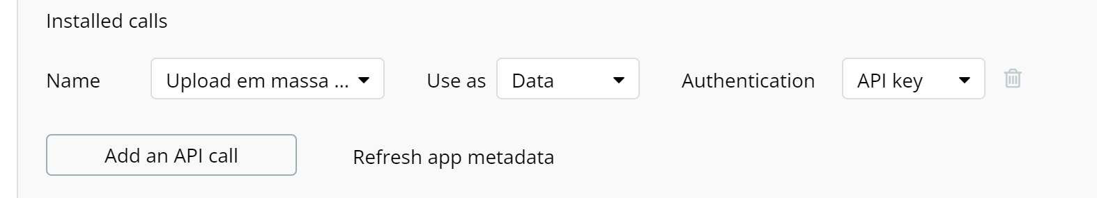

In not finding the ‘Run (appname) (workflowname)’ action on the normal workflow, does any one knows why?
Have you added the call in the App Connector settings?
do you mean the App Connector plugin set up process?
no run option
Change the “Use As” dropdown from data to action.
Data APIs can only be used in dynamic expressilns, action APIs are workflow blocks
