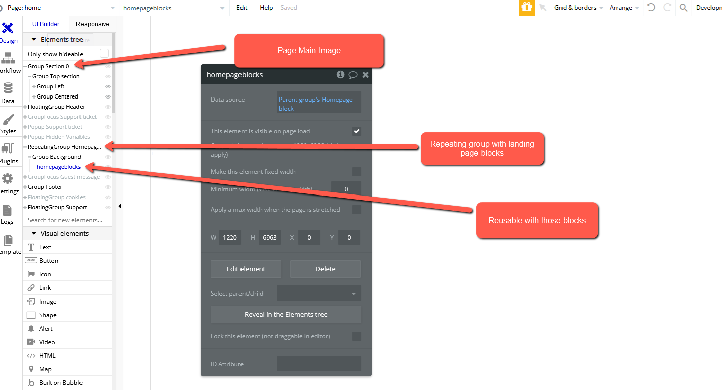

I am using @AirDev Canvas template. There is a Home page with the repeating group (blocks of the main landing page content).

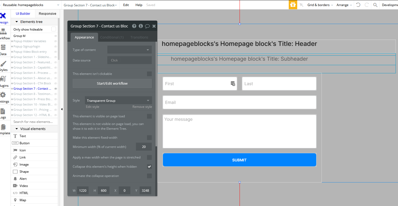

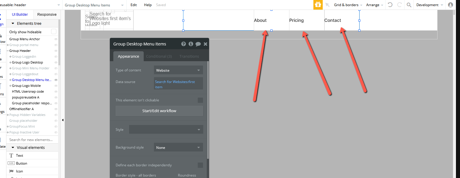

I want to create the action: when user clicks on ‘contact’ in the header menu, the page will scroll to the ‘Contact’ field. That ‘Contact’ field is in ‘homeblocks’ reusable, and that reusable is in RG on the Home page.

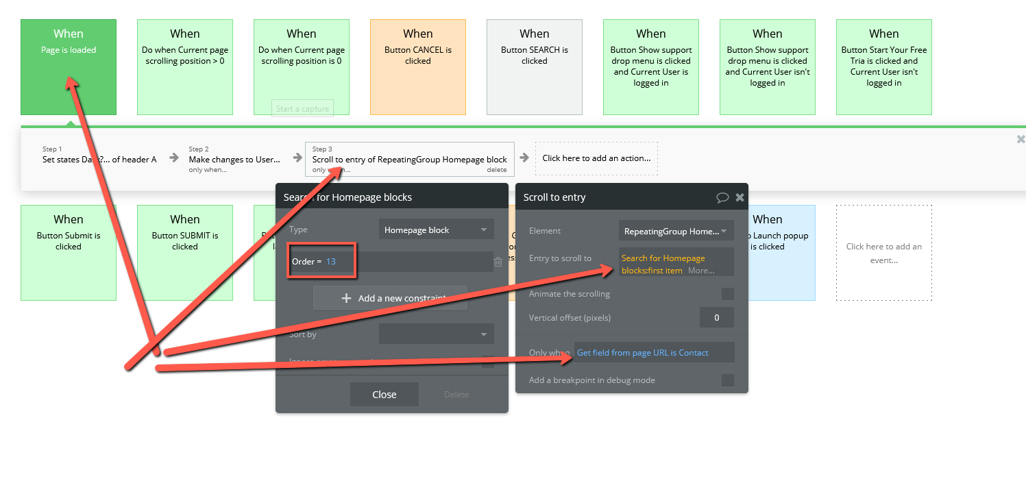

I can to point the ‘Contact’ directly, because ‘Contact’ button is in header, ‘Contact’ field is in ‘homeblocks’ reusable, ‘homeblocks’ reusable is in RG on Home page:
You can see the ‘live’ app on makeitly.com
I also can’t access ‘homepageblock’ reusable from home page to run ‘custom for reusable’.
Probably because of that reusable is in RG?..
Trying to achieve that by going to Home with URL parameter when click on Contact in header:
It seems as a bug, as it give different results when running Debugger in Normal vs Step-by-step mode.
In Normal mode it only scrolls to the GR first element (About)
In Step-by-step mode it scrolls to Contact us form
Have no idea why that happens
Here is the video of behavior:

Yep, I did that. Unfortunately, that not worked as it scrolls only to RG itself.
Actually, it behaves differently in Debugger Normal mode vs Step-by-step mode (mentioned that above)
I implemented that through ‘Do when condition is true’ and used URL parameters.
Seems as working now.
Just did that, right now, testing
