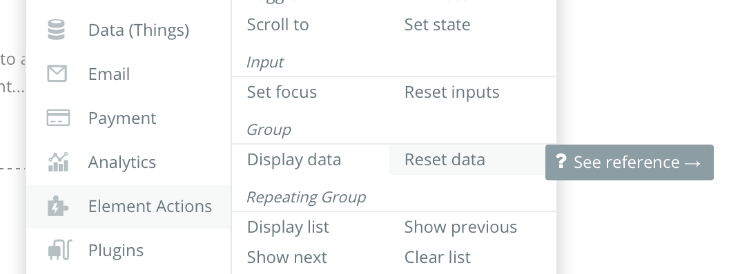

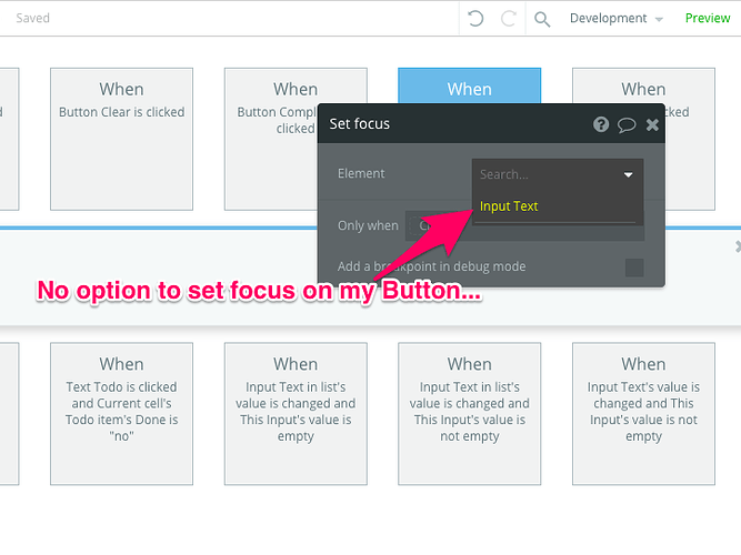

When I go to set the focus on my button, as part of a workflow, my button is not available – only my text input.
Is that possible with bubble?
This is what I see when I try to modify the example Todo app:

Right now only available on input, but maybe new plugin can do the job, @jarrad ? TAB will switch to the next button or input.
Setting the focus would be the wrong term in the case of a button. I think what your after here is scrollTo.
