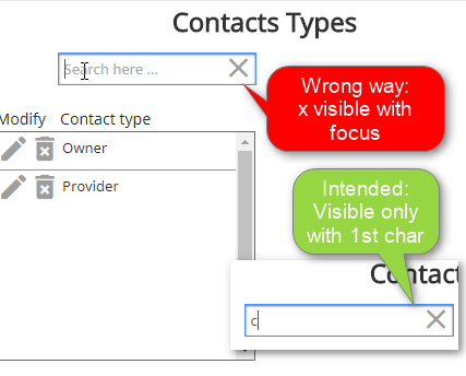

Because someone helped (do not know who), it is now working, as soon as it gets focus.
But it must to stay visible only when have typed the first letter …

This way don´t work too:
2017-09-22_11h11_33

Yes, it is correct, “This element is visible on page load” is unchecked. When the page loads the icon is hidden.
The problem is that it is visible when the box receives the cursor, without any characters. It should appear only when it has the first character.
It’s an icon to clear the content of the box, but the box still does not have any characters and the icon has already appeared to clean … nothing!

The condition must react to Searchbox’s typed text, or it will not disappear until you actually return a search result.
Following this argument, the condition would be, “This icon is visible when the Search Box has typed text,” but it can not be constructed like this.
The “This Search Box” function is only shown if the selected element is the box …
Then it would have to be “This search box has text typed” … and what to do to the icon and how?

I recreated these steps again with new elements and it does not work. Does not show icon.

I just tested it myself, and you are right, it doesn’t show up, even when there’s typed text. To my knowledge, this should be working, and I suspect this might be a bug.
I would report it at https://bubble.io/bug_report and see what they say. It might be a quick fix.
