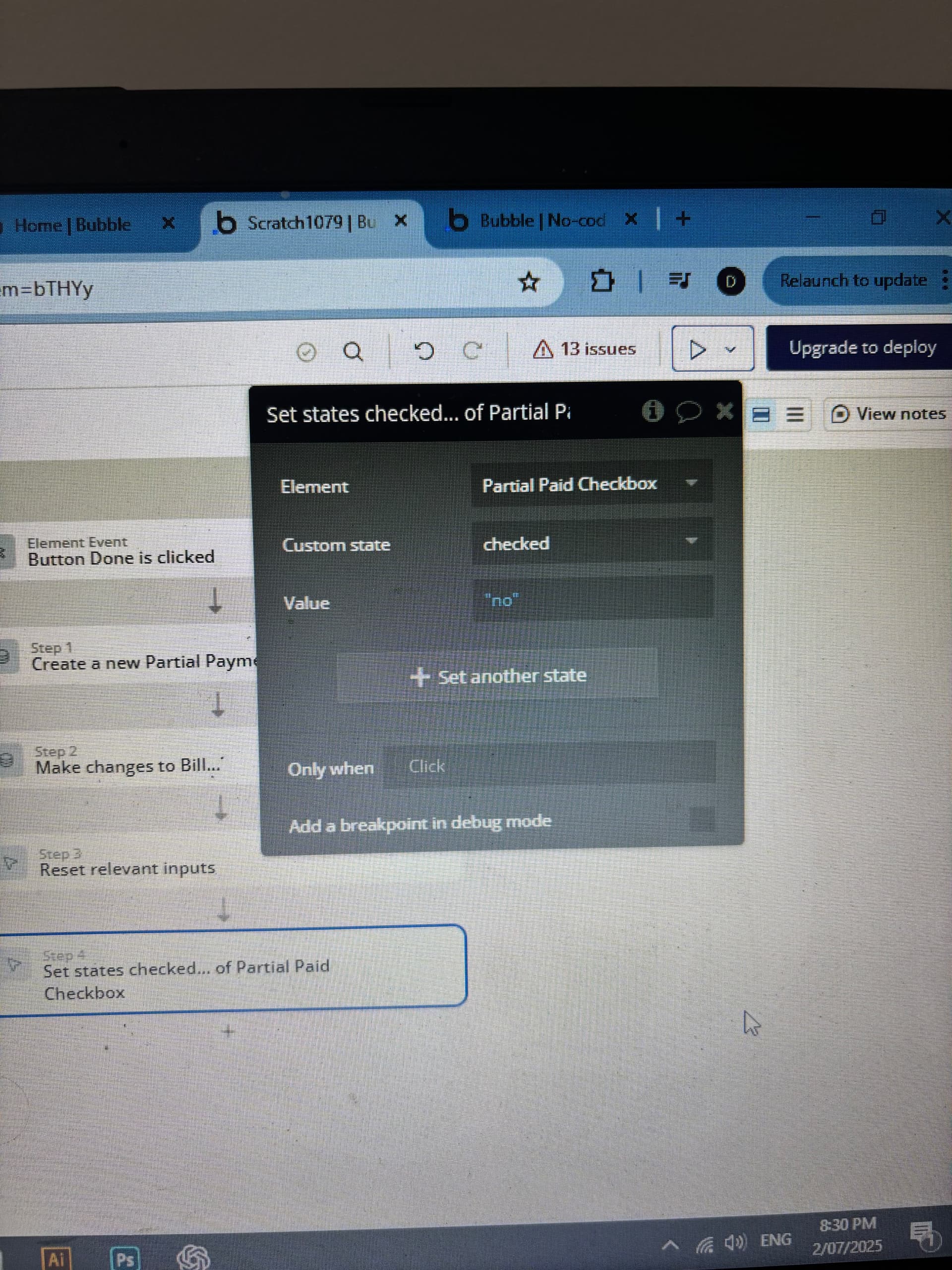

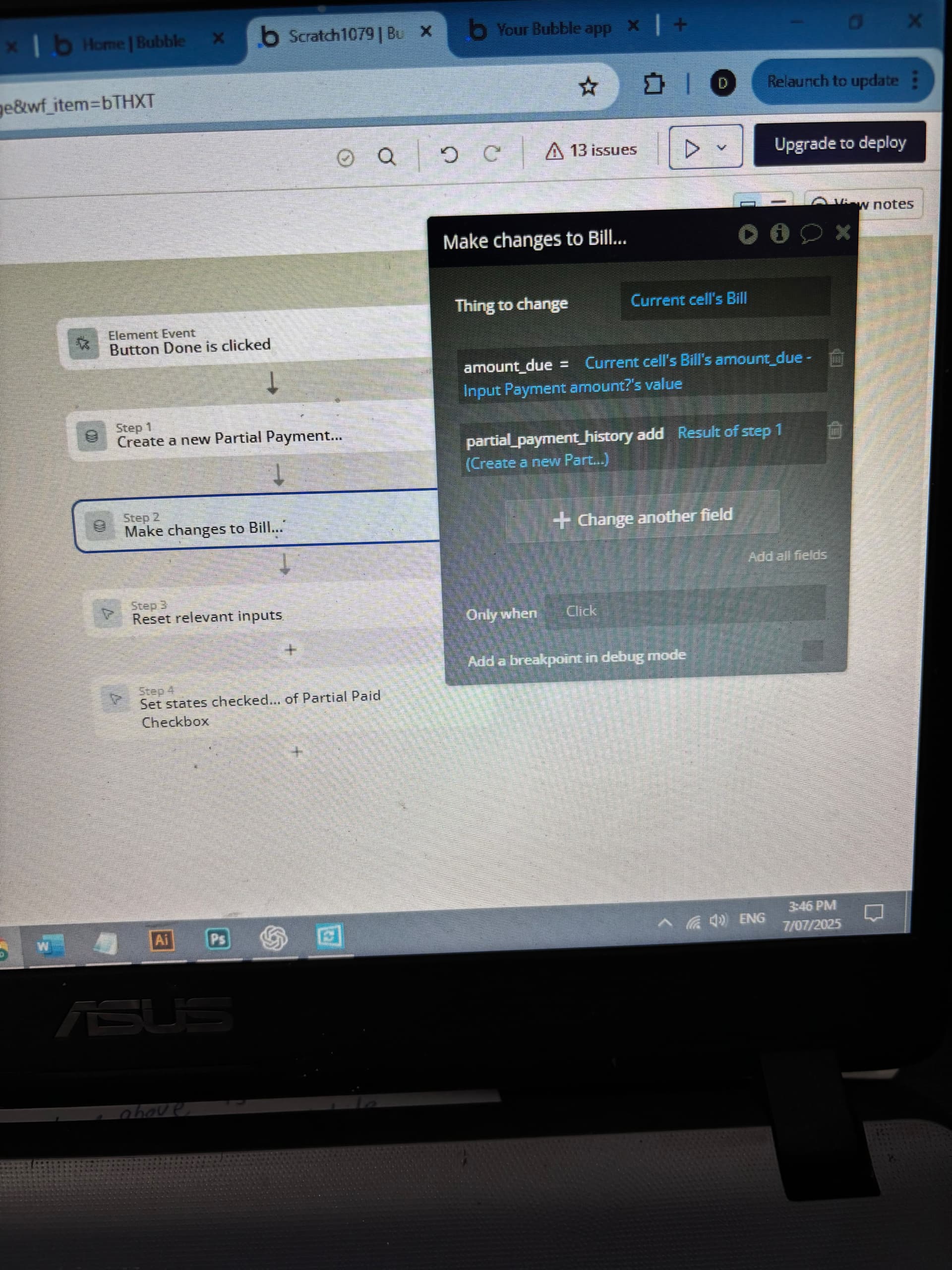

It’s not working, I click the done button and it clears the input field but it won’t uncheck the checkbox
Hey @scratch1079 was it resolved. If its not resolved yet, can you share a screenshots of your workflow settings

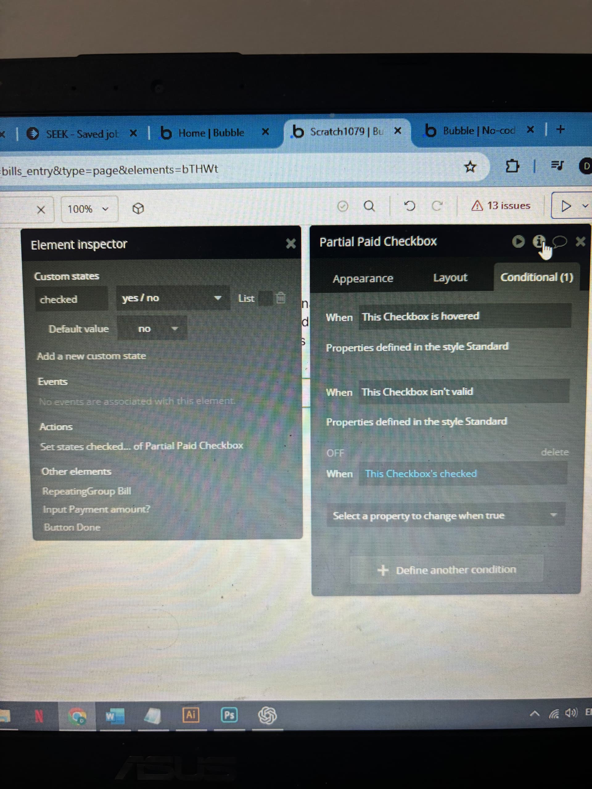

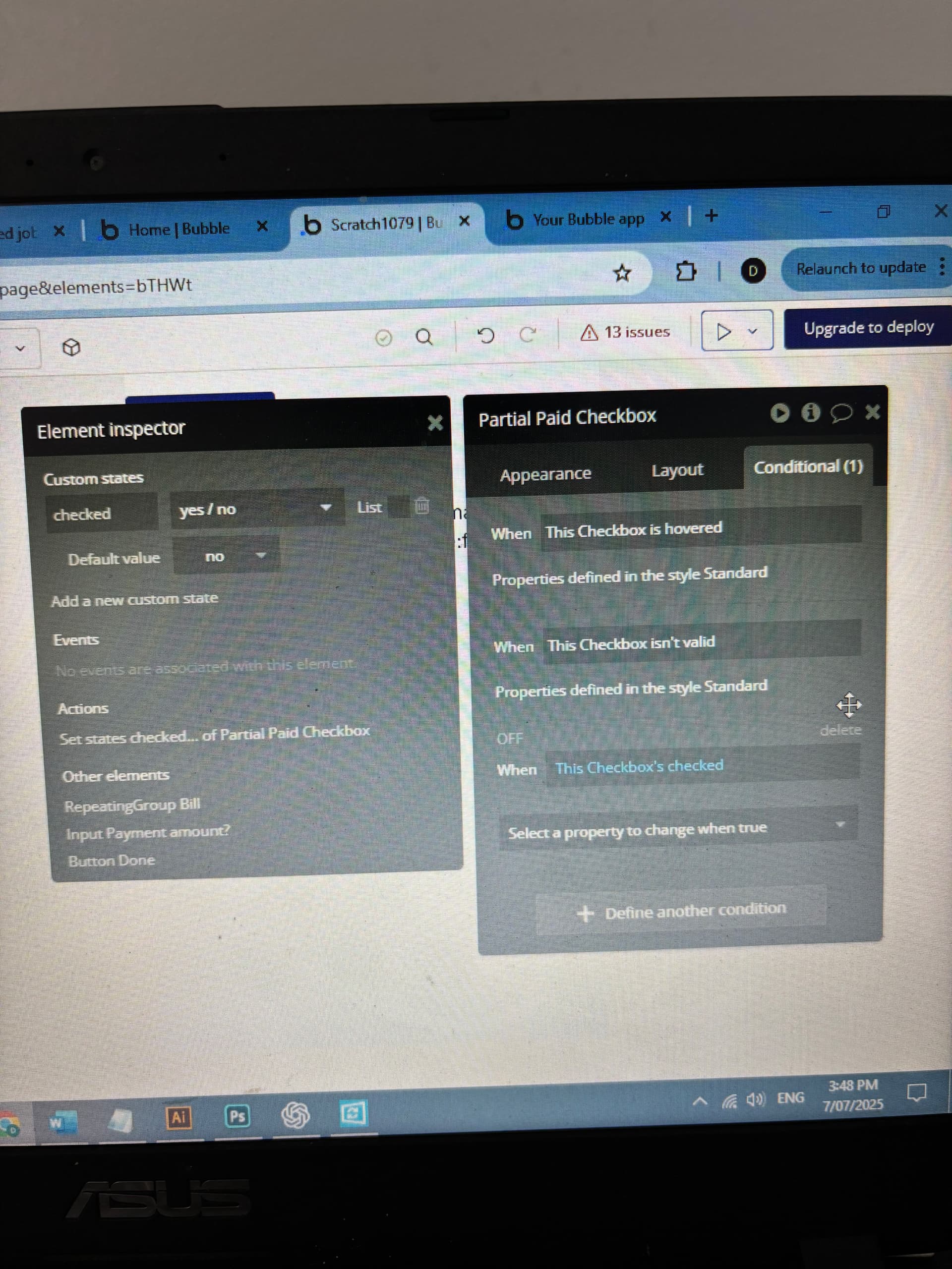

Fixed, I needed to set the visual states in the workflow
