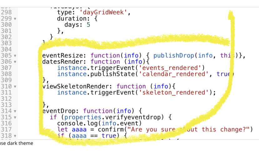

I get an error saying event_clicked is not defined when it actually is…
Have you followed these steps?
when you follow these steps above you’ll find your action in the workflow menu like this
That did it. Thanks!
