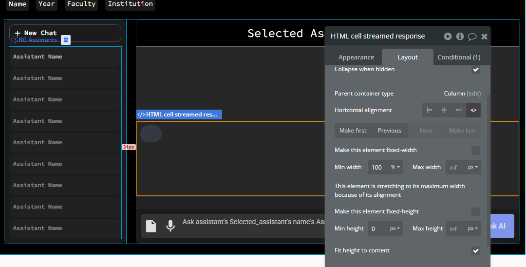

Okay not a Bubble expert yet, but I have a similar setup in one of my applications
This is how I have my layout setup:
I would also recommend checking 'wait to render element until it is visible on your appearance tab for the html element
Finally, I would also recommend having a LLM adjust your code to fit the html element height to the content. You could use my code as a foundation but tell it to remove the MathJax library:
Please don’t hesitate to reach out if you encounter more issues
Also I just thought of something, assuming you have the html element in some kind of group nested within the repeating group, make sure you don’t have a maximum height set on it.

This is where it gets awful. Trying to get bubble to use the whole screen and never have ‘main scroll bars’ is a real pain, and I regularly break it.
So - my page is:
a column - with a min height of 600 and ‘full width’ as the ‘preset page’.
In that I have 1 main column: PageColumn - which is min 280, height 100%
In Page Column is ‘Main Row’ - height 100% no scrolling.
Main Row has 3 columns: A and B have no html elments and work fine.
Column C is our Chat column: it is height 100% min and max 100%
The Chat column has a stack of other columns:
HEADER BAR: fixed height 30px
Debugging Group: fixed height 0px
under debugging group is a row: ‘Group Result Area’
This has height min 25% may ‘inf’.
That row has a column in it called ‘group chat’ - with height 100%
group chat has the repeating group ‘messages repeating group’ with height 100%
the items in the repeating group are in a ‘row: group this message’ - min 60px max ‘inf’. with fit height to content.
this has some fixed height images - like my head, or the arro logo,
plus a 5% to inf html label to introduce the message (who said it, which model was used).
followed by html element ‘message’ with min 60% max inf - and it says: This element is fitting to its content, to change this, change its alignment.
So in that awful nest of hellishness that seems like its all necessary to not have left/right or top/bottom scrollbars whenever anything on my screen tries to get tall or wide - any ideas?
I do have a different page with this same arrangement, but it is not a ‘row of 3 columns’ - not sure why that would matter.
my page that works has:
page: ‘preset full width’
min height 600
Center column: min 280 max 100% (no fit)
Group debug: same thing (copied from here) - height 0px
Group Result Area: Row - height 25% to Inf (no fit)
Group Chat: fixed 100%
Message Repeating Group: 100%
Group This Message: Row: 60% to inf
picture 25x25 + html element(5% to inf)
finally ‘message’ with overflow problem: 60% to inf. ‘the element is fitting to its content…’
Hey @cawleyconsulting. This is super hard to follow, however, as a general practice avoid hard coding the maximum height rather set the relevant groups layout to vertical stretch and enable vertical scrolling.
As for getting rid of the scroll bars I would advise just running through this video should solve some of your issues. If you encounter other issues let me know: https://youtu.be/rLHKcg5-D1o?si=J5-VqZpP8f22JtXM
