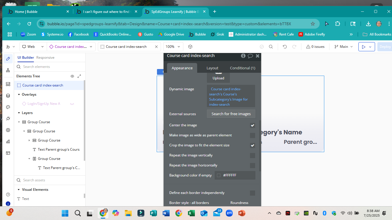

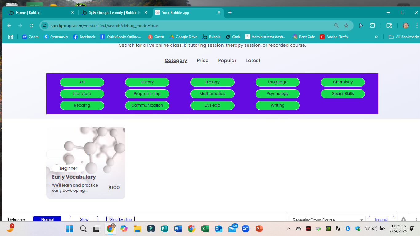

I can't figure out where to find this photo to change it
I don’t see anywhere that anything says anything about any image for the repeating group of courses. Yet, there is an image appearing. It’s not the image I have in my data for the category or subcategory. I don’t have any images in the course data type. Any help would be greatly appreciated.

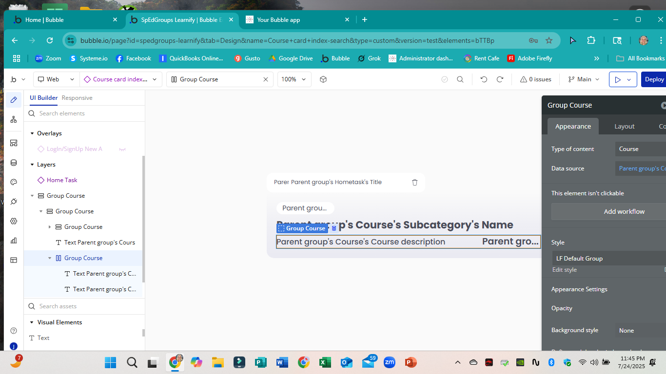

What is the reusable element called Home Task inside of the reusable element Course card index?
You’re not showing that group in your images…
so, I can’t tell how the group is set up without seeing it.

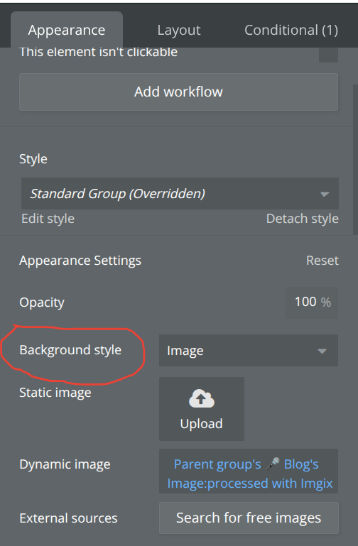

But it appears they have a background style set to image. If that’s the case, which it appears to be, you won’t find an image element.
You’ll need to modify the background image to change it.
It’s just a homework assignment with no picture related to it.
You’re right! There it is. It seems to be pulling up old pictures for the first two though. I changed the pictures in the main and the live DB for subcategories, but it’s still pulling the old pictures. I added a new course and it pulled the subcategory picture though.
I’m assuming the images are stored in an attribute on an option set?
You would need to go to that option set and click ‘attributes’ and change the image to whatever you wanted.
I found it! It was on the live DB, subcategories “image for index search”. Thank you so much for your help!!
