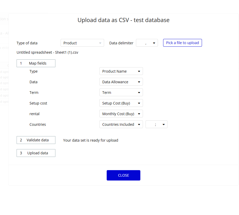

So im importing it into bubble and then mapping the fields as below:

Does this mean its worked and all i needed to do was that? And if so…Its imported the countries correctly (United kingdom, Germany, France) but it seems to have missed out the last country in the spreadsheet field “Belgium”. Is this something I have done wrong? I have checked and Belgium does indeed exist in the option set. I note it didnt replicate this process for the second product (50mb) either and shows no countries for some reason.
Thanks for all your help with this
Hmmm… to debug, can you create a new Option Set (you can use the extension helper to bulk import it) and create a new Countries list field on the data type? I’m thinking maybe it’s considering deleted option set values or some other issue we can’t see…
