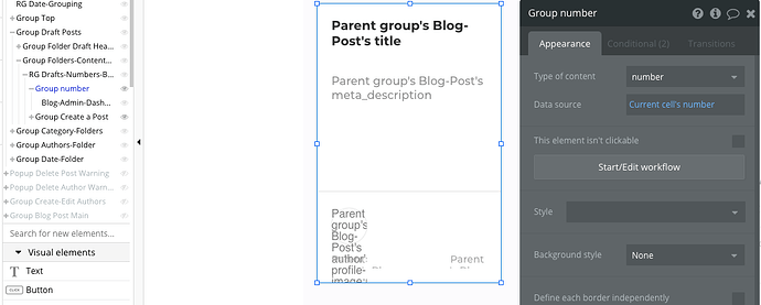

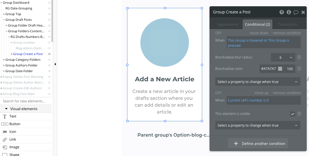

Is there a way to add an upload button to the end of a repeating group of the uploaded images?
How would I go about adding an upload button to the end of the repeating group?

You use a list of numbers as the source for you repeating group and then some more quasi complicated setup to display the button in the last column while the images are displayed in the others.

Ive been searching the forum for a solution, havent been able to find one
Screen Shot 2021-02-04 at 11.14.09 PM
Screen Shot 2021-02-04 at 11.10.40 PM Screen Shot 2021-02-04 at 11.10.50 PM
I use this method in my template

Thanks @boston85719 I’m going to try it out
Thanks @boston85719 it worked. greatly appreciate it!!
