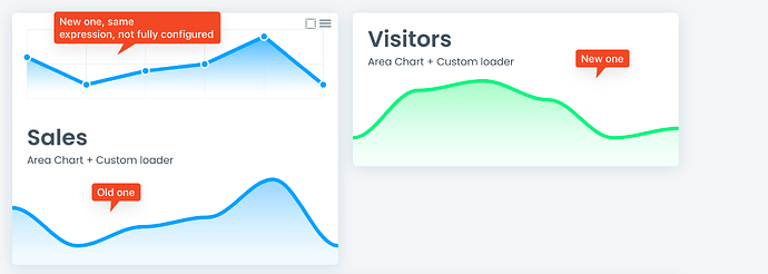

The old charts I have set up using this Plugin are working just fine, but when I set up new ones, they don’t return data or the chart is completely invisible.
I have been using this plugin for a while all over my bubble app, I’ve never seen an issue with it until this week. Even when I copy and paste the exact same functioning chart in a different page, it doesn’t work.

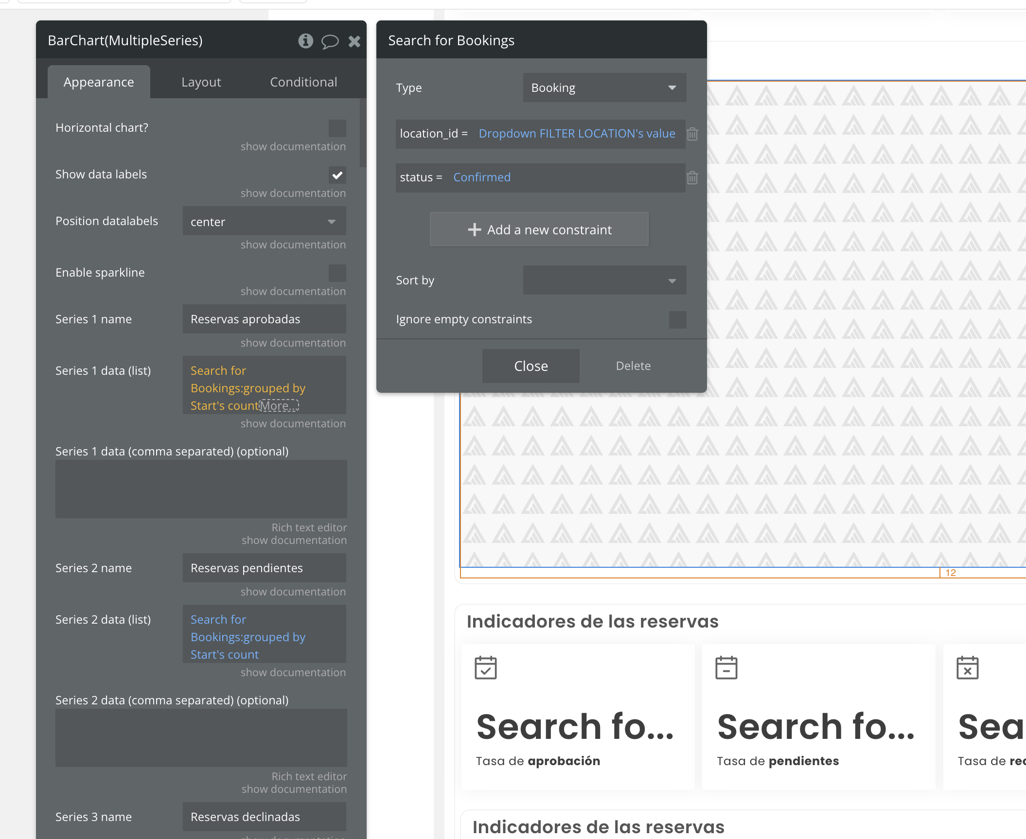

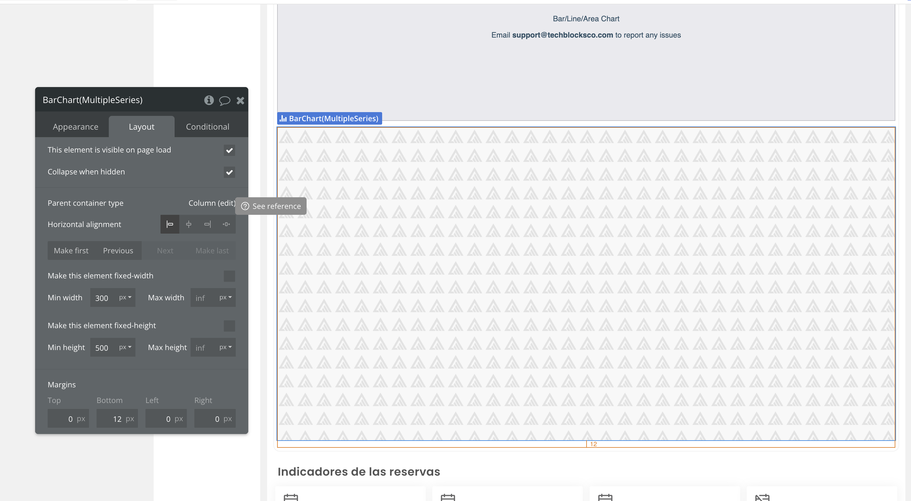

Chart 1: BarChart(MultipleSeries)
I am sharing below the debugger, and the layout confirming that the chart is visible and not carrying any conditional.

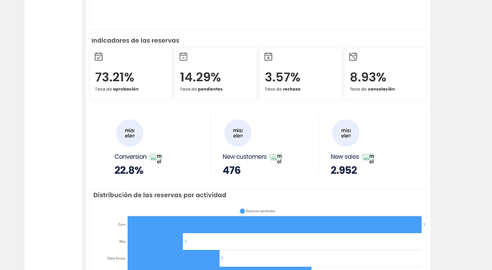

Chart 2: RadialChart
For this case, I have copied and pasted the exact same Radial Chart in the plugin page (Editor) with static value to double-check if my setup or my chart configuration is not correct. However, the chart is still not displaying data.
The weird part is that I have these charts from this plugin set up in older pages and they are working just fine. But start facing issues when setting new ones since past week.

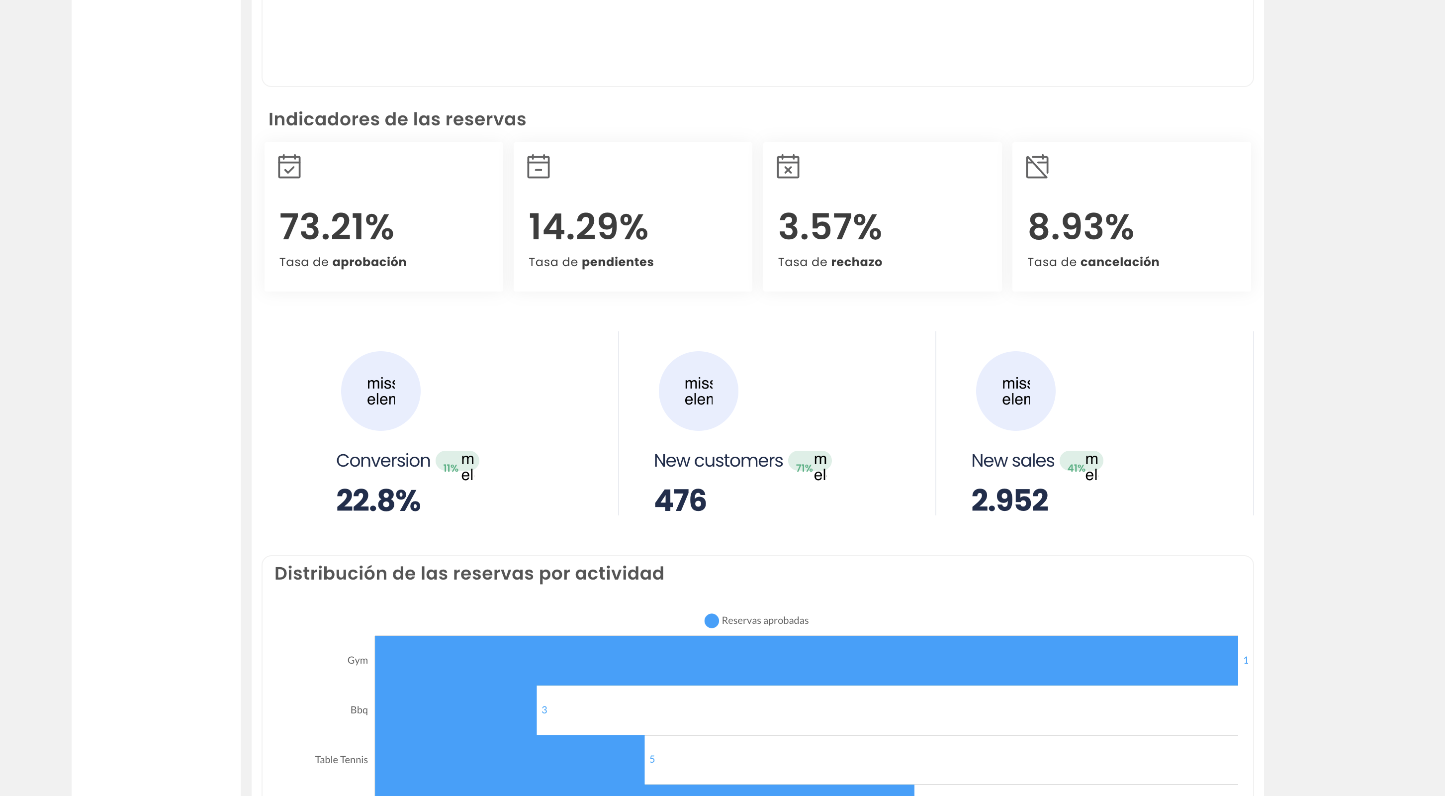

Hi @ZeroqodeSupport ,
I am facing again some similar issues like the previous time, mainly with Radial Chart not returning data. (sometimes it does…), it is very inconsistent.
I have added you as a collaborator, you can verify the page here: Link
When inspecting using debugger, I can see that the chart returns data, but the UI is not reflecting it.
