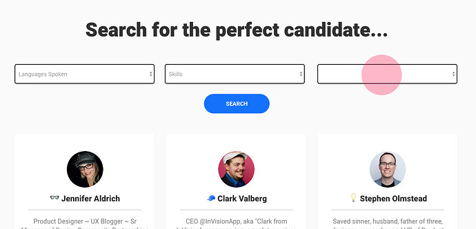

Currently building out a search where a user can search via Languages Spoken (all good), Skills (all good), and by a Timezone ID (ie; Europe/London or America/New York for example).
The issue is with the Timezone ID search which hangs on page load, and leaves an empty field for at least 2 minutes before any data appears in it…

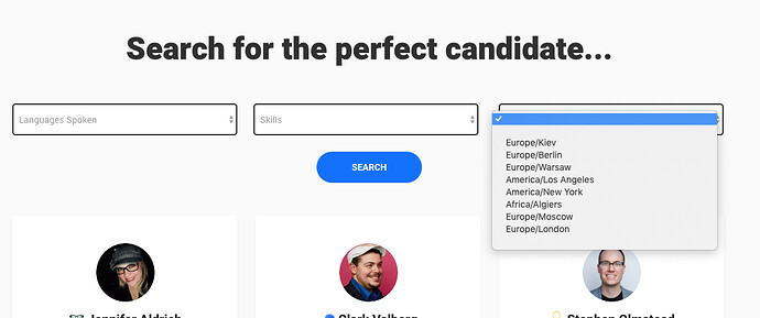

When it does load you can see it is only showing the Timezone IDs which are currently attached to a user. Which is probably a good thing so you don’t have a dropdown with 200 Timezone IDs in it…

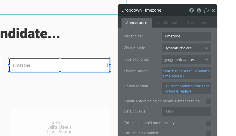

These are the settings I have in the Editor…
Are these correct? What would be causing the hang? Is there a much better method to use?
Many thanks
I think the issue is there’s just so many Timezone IDs… it’s going to take a while to populate.
What’s the search & replace doing? (And is the dropdown population faster when you remove that? (Note that what’s going on here is the search for Timezone IDs must complete and then the search/replace is iterating over all of those.)

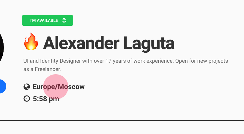

I do have it where when a user edits their profile and adds their location (ie; St Petersburg, Russia), their Timezone ID is then displayed on their profile when they click Save Updates.
Could I not get the timezone ID added to the User data type when this is done so there is a permanent record, and you’re not calling upon Google each time? Surely this would help speed things up?

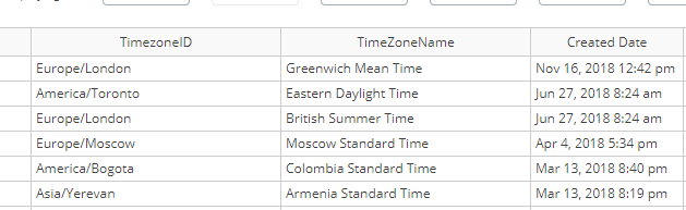

If you want a list of current time zones - you can store the Zone ID and Name when you save the user.
Name (Eastern Standard Time etc) might be easier ? Rather than Id.
Then just pull a list of unique elements as text.
Pinging the geo lookup for every address on the database … is not going to be the best way :slight_smile:
I do this in Teamytime to make it faster.
