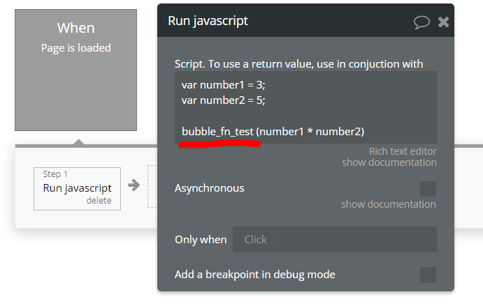

After downloading the Toolbox plugin you will notice that you have a new element to drag and drop into your editor, called JavaScript to Bubble. Drag and drop this element. This is the element you will use to receive the variable from your JavaScript snippet and make it visible to Bubble.
Note that in my case, I am expecting to receive a NUMBER as variable.
Also, in your workflow section
You will use the function “bubble_fn_xxxxx ()” to pass the result to your Bubble element. In our case, the function is “bubble_fn_text ()”. As you can see, after I run the code, I can load the result anywhere I want…
The result:
I made this for you. Click to check the editor.
