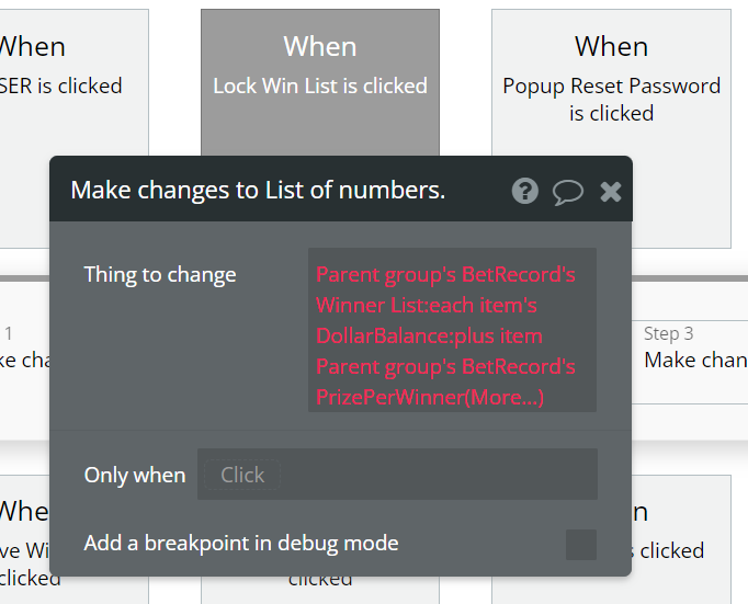

when the user click on a button (Publish winning results) i want the workflow to change every user’s balance that exist in a certain list (winners list)
I choose in the workflow the option:: Make changes to a list of numbers => Things to change => the winning list’s balance account => add each item the winning prize, but it didnt work

Its confusing, when i try to change list of things the error is: “its user related change” when i try to change user date i cant see the list
Maybe its too much indirect addressing… to much nested location ?!
I though you wanted to change a list of Users?..
(in your screenshot you’re trying to change a list of BetRecords, but defining a list of Users, hence why it’s red)
Im trying to change a user field to only selected list of users
As Adam said, you have the type of things set to BetRecord, but you are specifying a list of users. Have you tried changing the type of things to User?

If you select User as the type of things, you should still be able to select Parent group BetRecord's Winner List as the list to change (assuming that list is a list of users)… so I’m not sure what is going on.
But, based on your original Queston (of making changes to each User in a list), it should be as simple as setting the Type of Thing to change to User, and then defining the list in the List to Change…
As long as that list is a list of Users then it should work…
If it doesn’t, then presumably the list your defining is not actually a list of Users.
It shows no errors now :smiley: :star_struck: :clap:
