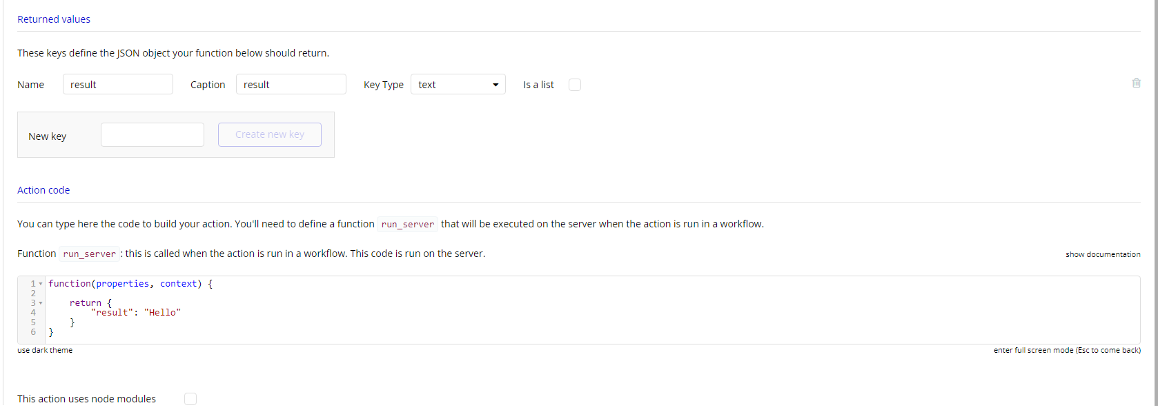

My actions script is not returning anything
Hi, I know this question probably seems very stupid and basic, but can anyone tell me why this isn’t returning the result?

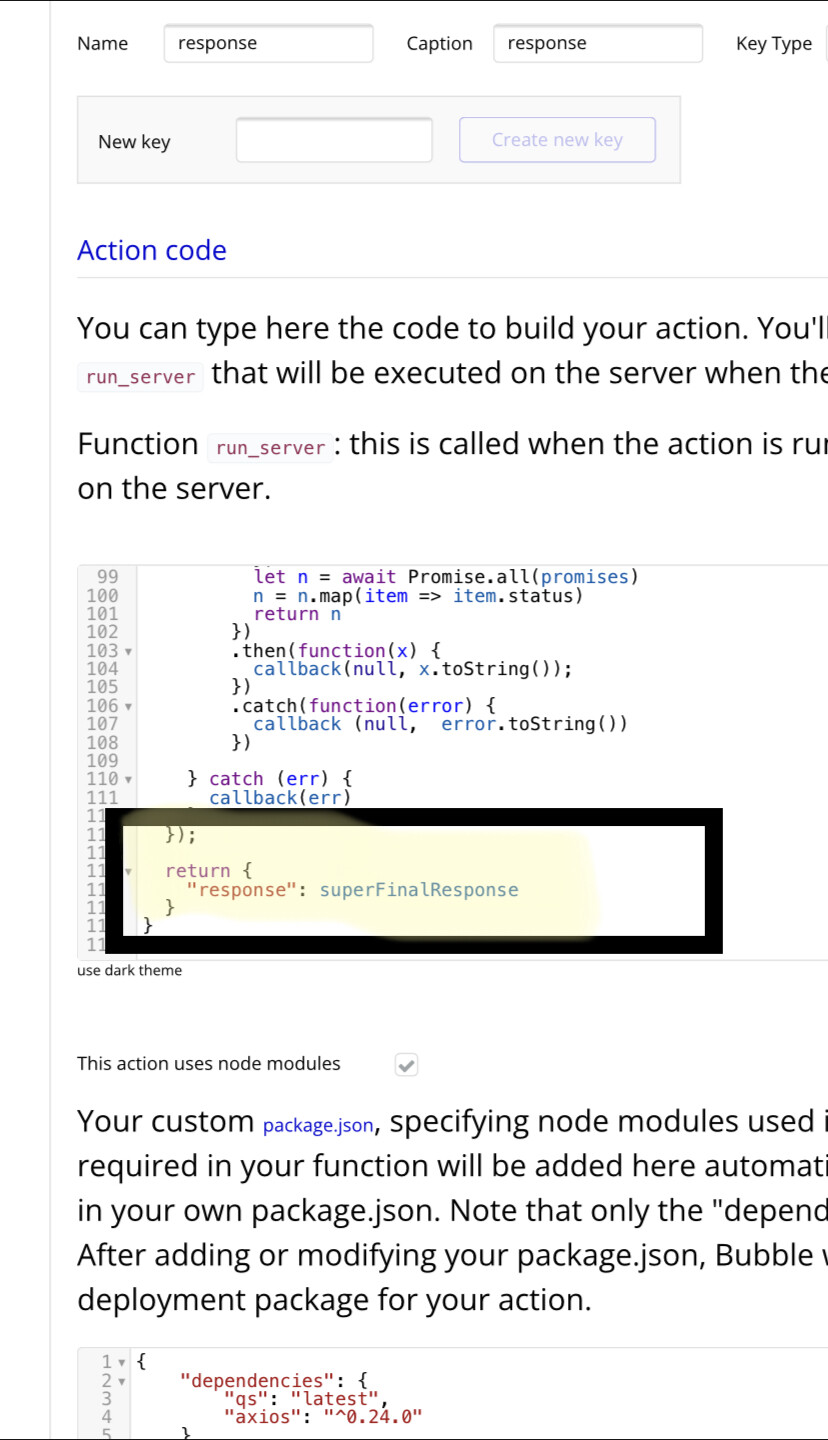

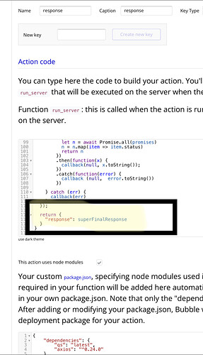

Try formatting your return object key with parenthesis
In JSFiddle that reports as a “line breaking error” after the return statement. Try moving the left-handed opening curly bracket up to the same line as the return.
Hi @aaronsheldon ,
this still isn’t working for me.
Just to confirm, all I need to do is refresh the plugin page and the preview of the app im testing on for it to update?
Thanks for your help aswell
Thanks I think I’ve done that and I’m still getting nothing
EDIT: This is working, thanks both @jared.gibb and @aaronsheldon for your help :slight_smile:

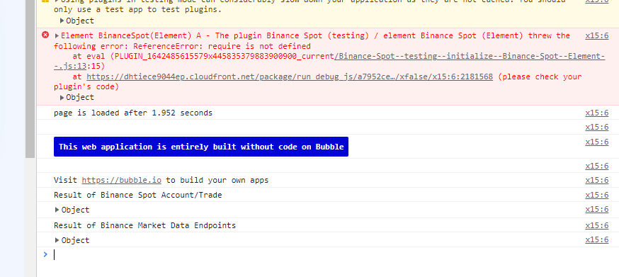

@aaronsheldon This works great for server side plugins. Do you know how to import javascript libraries into client-side elements? I am getting the following error thrown
Also is context.request doesn’t seem to be listed as a method for making api requests in client-side elements. Do you know what the best practice is for making custom api calls client-side? Thanks
The server-side environment is run in Node.js. Likely no greater than version 15.0.0, because of the following deprecation warning from the Fibres maintainers, at the top of the page here. The requires syntax is a Node.js idiom that is not part of the browser ECMAScript Language Specification. I find the best documentation for the browser Javascript API is available at the Mozilla Developer Network.
You are correct in noting that the context.request() function is not available server side. As I mentioned before this functionality is provided by the Node.js Request NPM. Equivalent functionality is provided client-side. It is available in the Request API supported by a broad range of browsers, see the browser support table at the bottom of the page.
For loading resources you have a number of options.
  1. Most obviously the script element.
  2. The newer import function
  3. Within a web worker you can use the importScripts function.
However, you need to be aware that because of syntax and API differences you will often not be able to use native Node.js scripts in a browser. To do so requires a transpiler, typically Babel, which is run through a build automation tool, like Gulp. Furthermore, what you transpile to depends on the choice of module loading tool you want to use. A few of the options are:
  1. RequireJS
  2. SystemJS
  3. WebPack
Once you have built your browser ready code, you will then have to host it somewhere. The typical method is to publish to NPM which is then picked up by CDNs like unpkg and jsdelivr.
If at all possible I recommend working with pre-built libraries that are ready for browser consumption and can be loaded using a script element. If they are well built and supported they will dynamically load the needed resources behind the scenes without you having to write any code, aside from the usual glue code for Bubble Element Actions, Events, and States.
Finally, when writing client-side code do not trust the environment you are working in. There is an enormous variety of browsers and versions in the wild on the internet. You don’t have to scratch the surface too deeply to find edge and corner cases of inconsistent Javascript API support across browsers, e.g. printing support.
