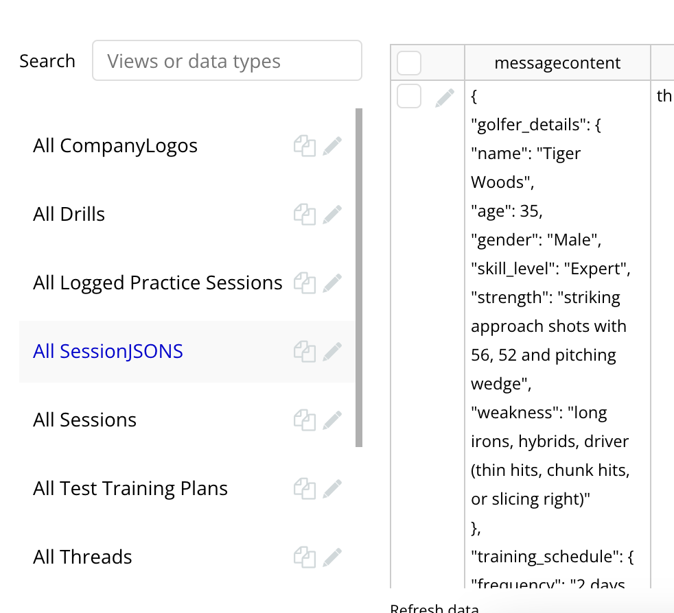

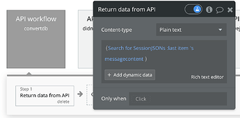

I am currently using OpenAI to send back a template for training via a json format. However, it’s well known that using the assistant api doesn’t actually send back the json in a readable format on the first go, I believe it captures the full response as “context”. Anyways, once generated, I take this json in the response and save it as a text data type in my bubble app.

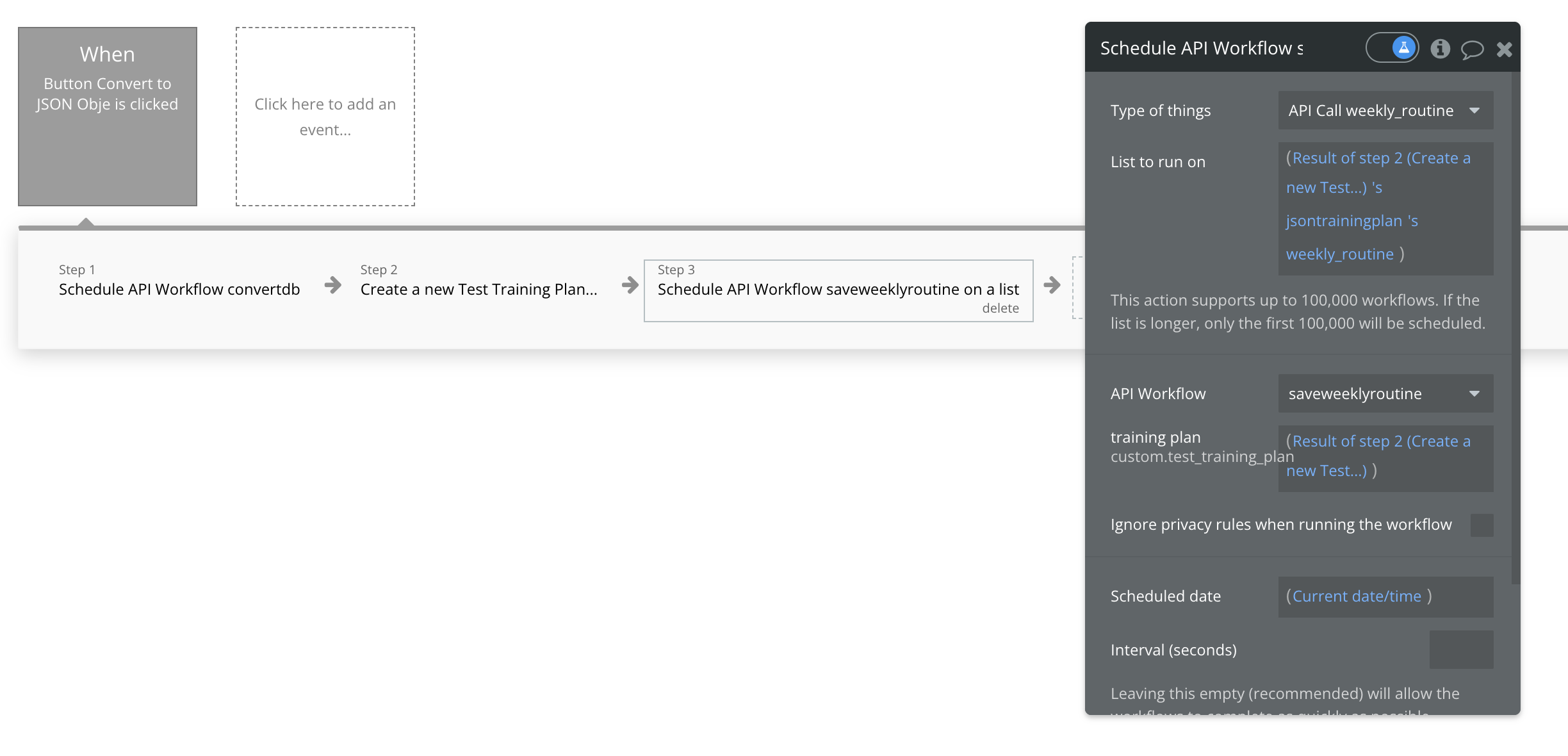

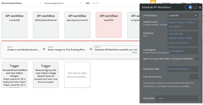

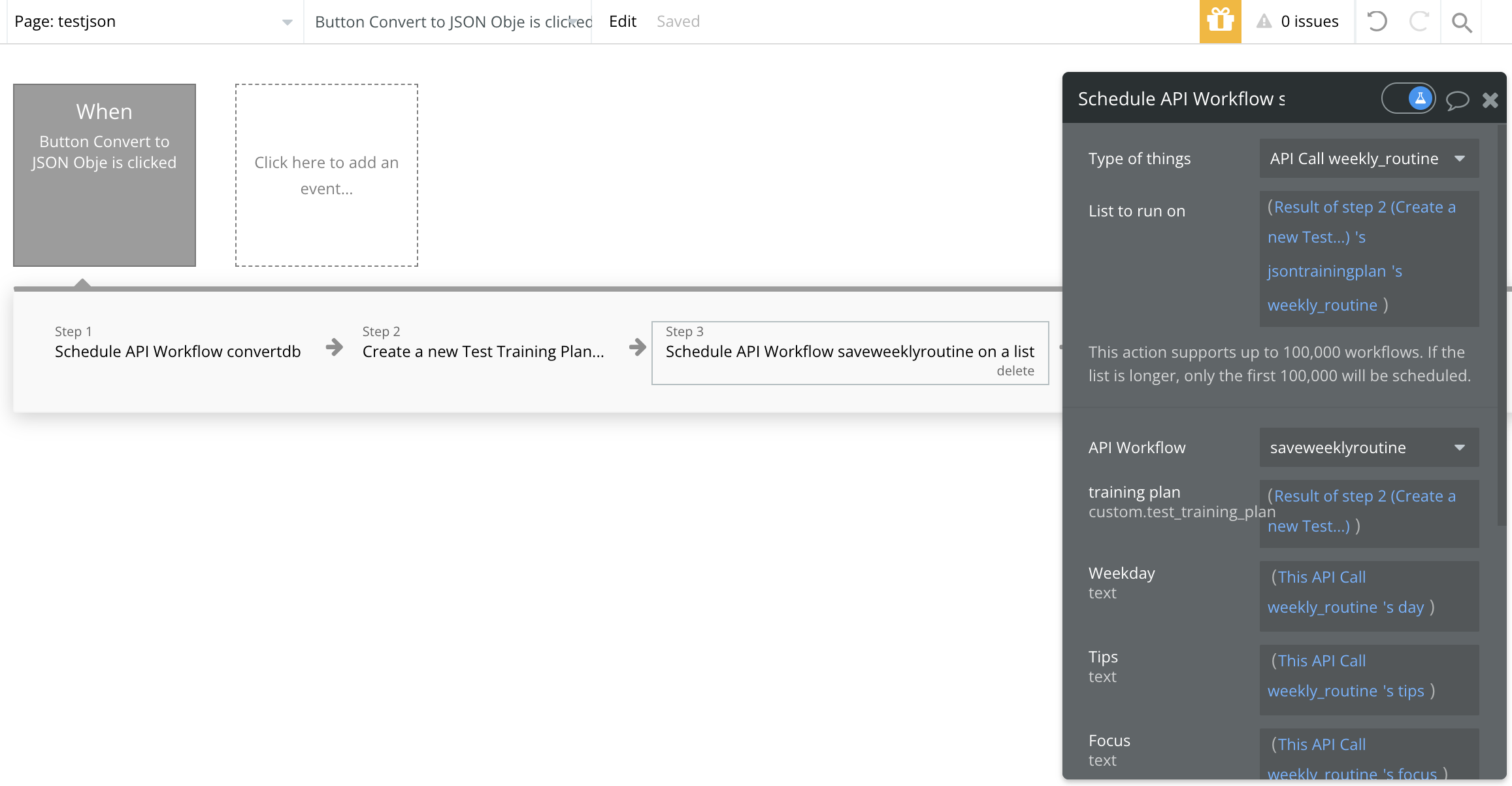

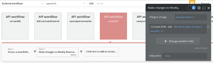

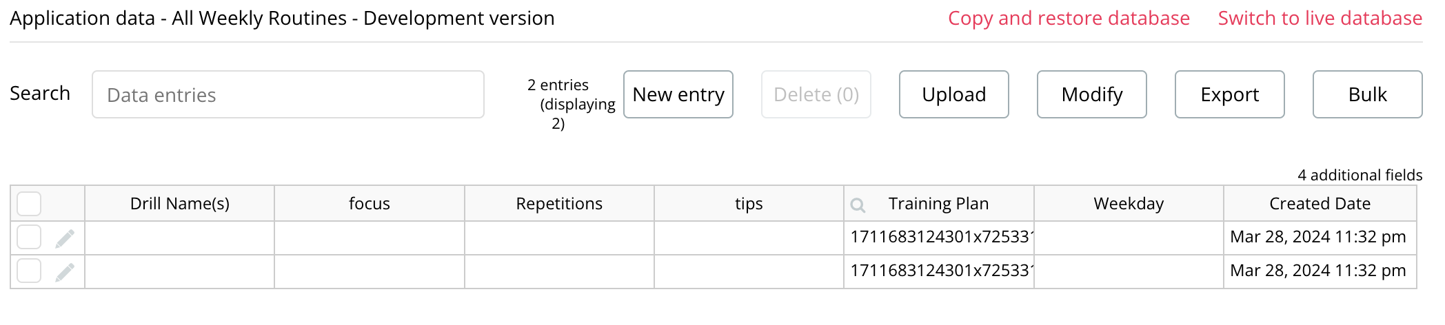

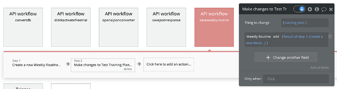

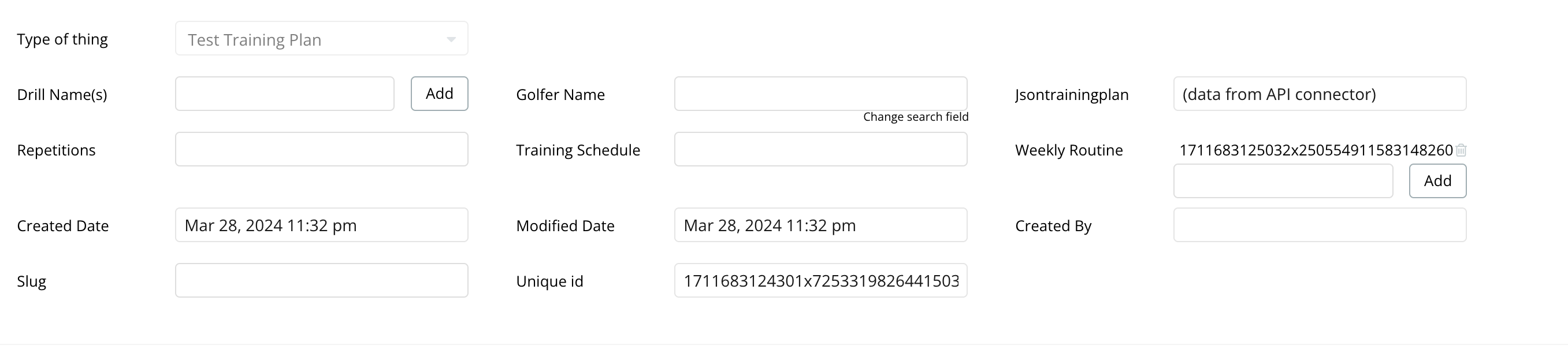

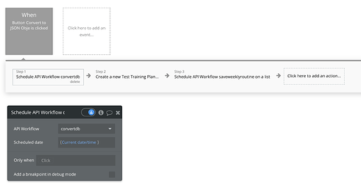

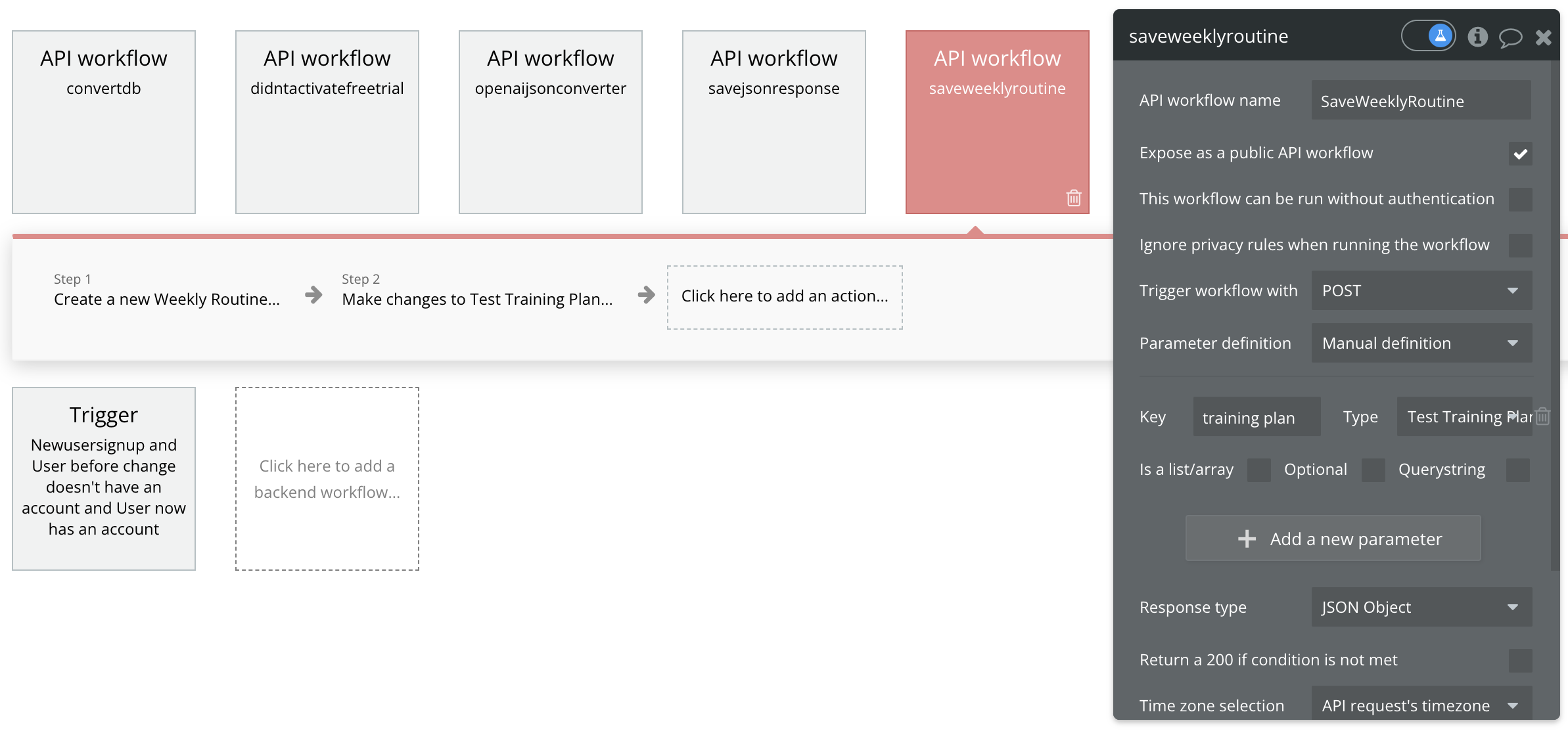

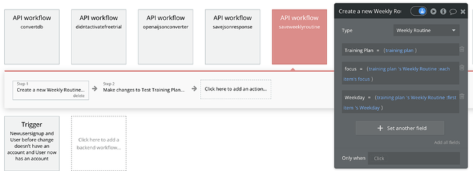

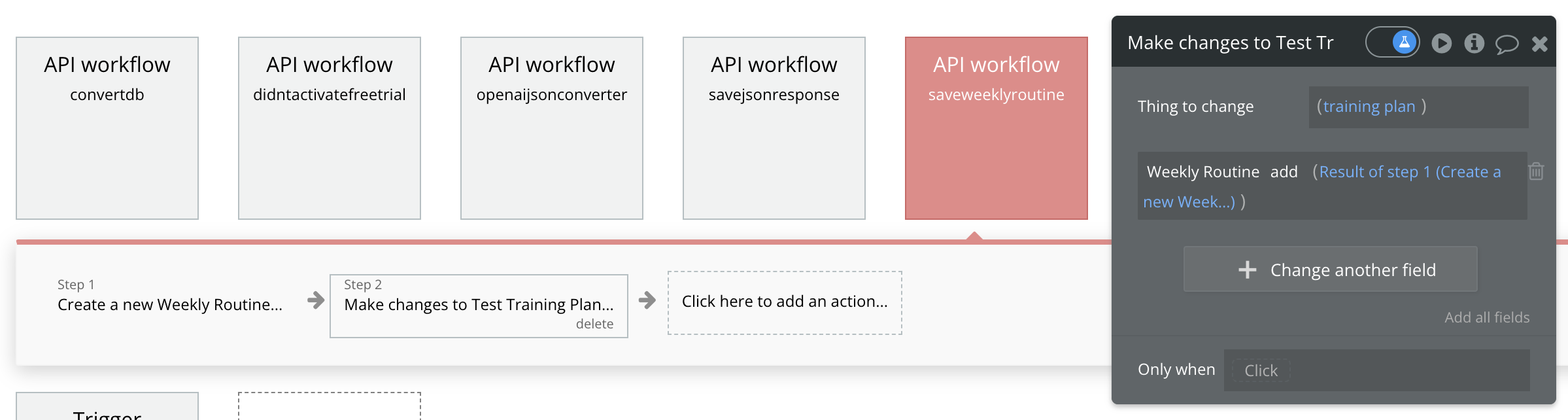

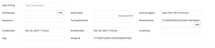

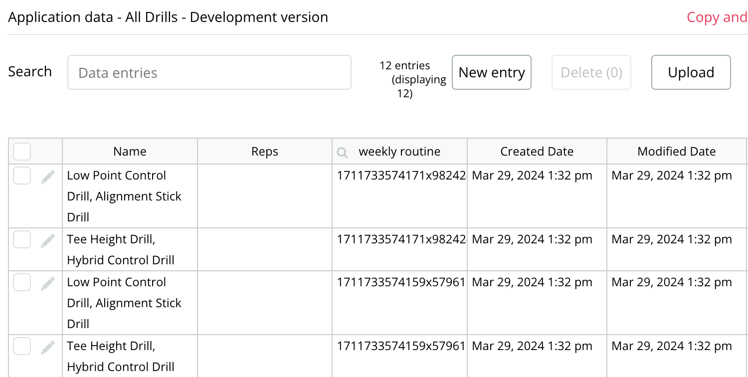

- Running a backend workflow on a list. I tried setting up a BE WF to take the original “context” that I’m saving in my database as text, running that through an internal api to parse the json, but having difficult saving the data correctly now. I think this is the best option, but also most likely the most costly when scaled.
Here’s an example JSON response where I struggle to successfully save the Weekly routines and drills under the correct sections.
