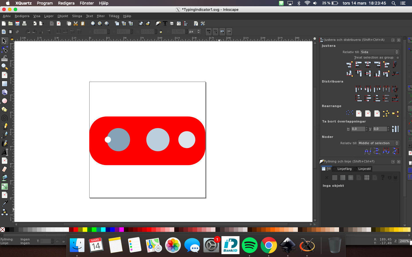

Here you go: //s3.amazonaws.com/appforest_uf/f1552584017935x671292158212950300/TypingIndicator1.svg
I used Inkscape to resize the whole document:
Thanks so much @jaos.pcl! This works perfectly!
I too was fumbling around Inkscape but only know as much about it as I do CSS, which is basically zero!
Happy to help!
