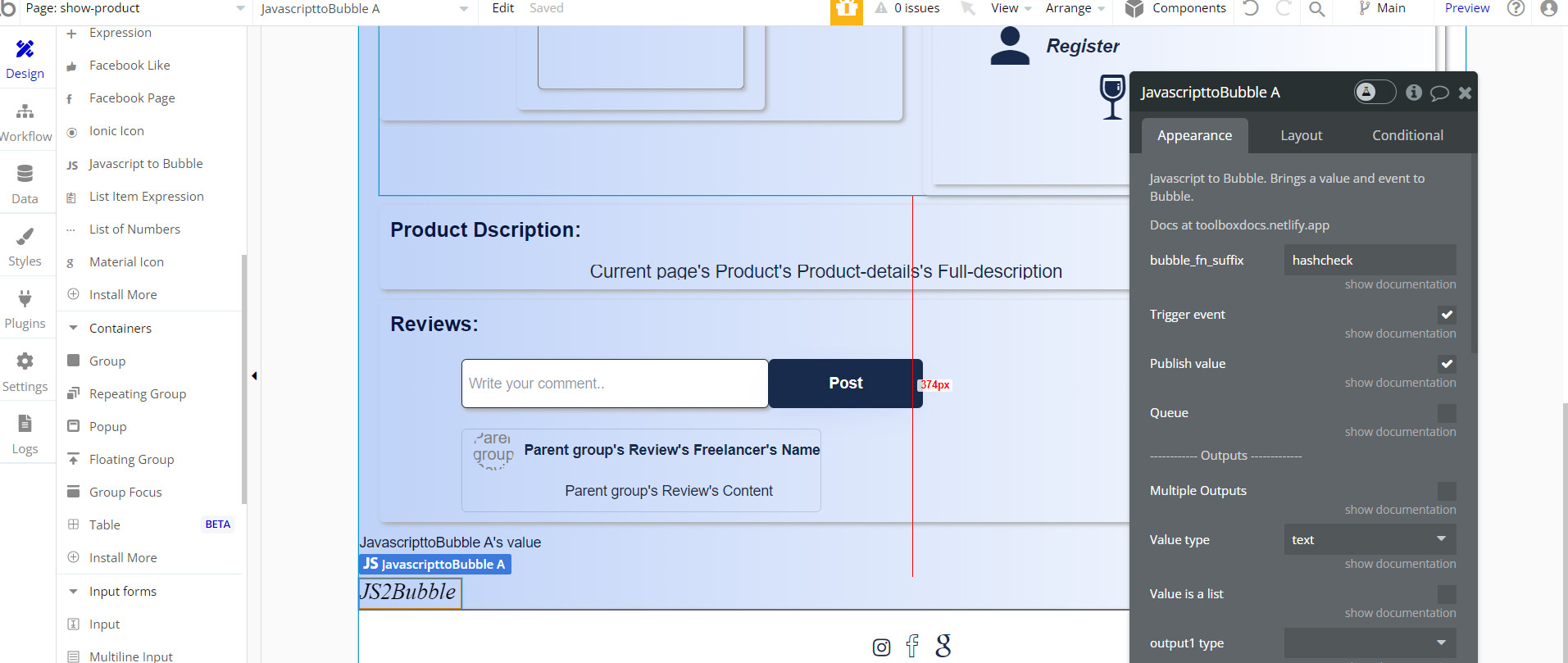

Thanks for your reply. Yes I am using Toolkit to add javascript code in the app.
Here is my run action using toolkit.
Please let me know if do anything wrong because I write the function name correct and call it correctly.
