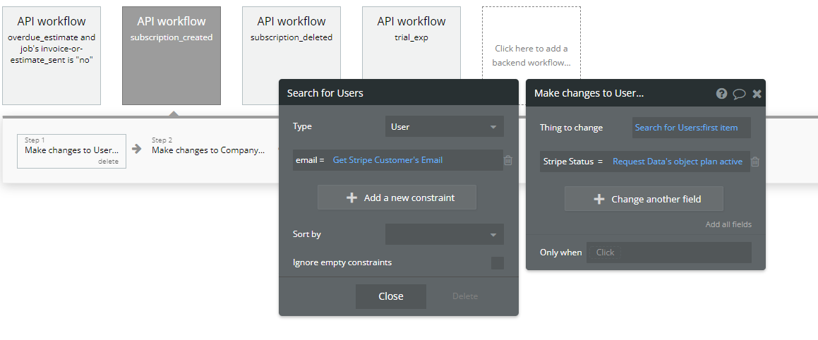

It’s so intuitive for me I can’t think logically, even with your explanation I don’t know what’s going on. I think I am trying to ask Stripe to find the customer who matches the Bubble’s current user.

No, there’s no such thing as a ‘Current User’ in a workflow triggered via a webhook (current User only exists in Bubble, not in Stripe)… what you’re actually doing is asking Stripe to show you the Customer of the Subscription event that the webhook is using…
It won’t let me select an email address from the dropdown so I am left with this:
Yes, that’s correct for the Get Stripe Customer Call… now click close, then select the email address back in the search constraints…

A Stripe Customer ID needs to be a Stripe Customer ID…
An Email Address needs to be an Email address…
Now, in your screenshot, you’re searching for a User by their Stripe Customer ID (which they still don’t have anyway), but you’re entering an email address instead of a Stripe Customer ID…
Forget about the Stripe Customer ID (your User doesn’t have one at this point, that’s the whole issue)…
You just need to search for the User by their Email Address…

@adamhholmes This ‘partially’ worked. The Plan_ID and dummy text were updated but the Status came back as ‘incomplete’, meaning in the database it says ‘incomplete’ in the Status field.
Nothing was updated in step 2 of the work flow?

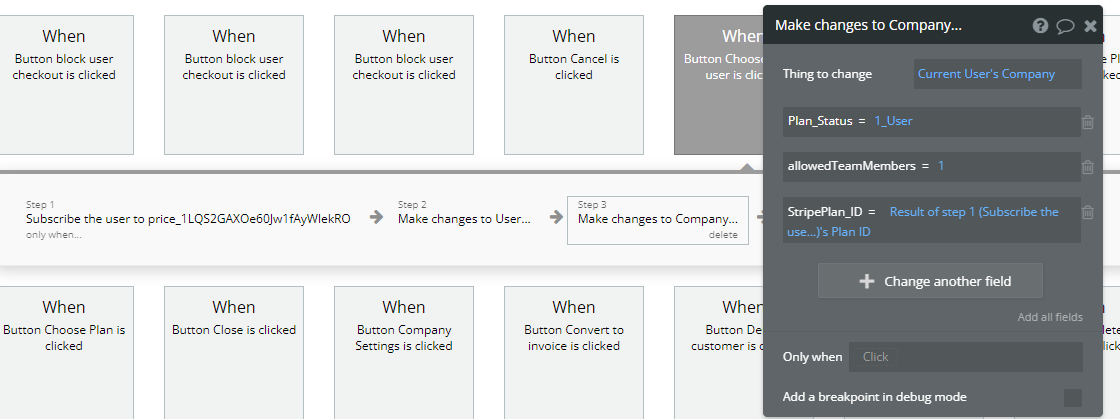

The issue may be that I am setting a Customer ID on the ‘Pay now’ button… although maybe that is fine?
I can’t answer that… assuming the status really is ‘active’ in Stripe then it’s possible there is a delay between the Stripe event being fired (which triggers your workflow) and the Status being updated internally in Stripe…
Again, I can’t see any obvious reason, but I’d guess it’s to do with your Only When Condition (which I don’t really understand…)
I can’t see why that should have any effect on anything here…

@adamhholmes I have finally solved this issue and it was a combination of a few things. Thanks again for your input.
For the benefit of all, the main thing was that I needed to “Get stripe customer email” instead of the “customer ID” , as @adamhholmes pointed out, because of the workflow delay when Bubble’s Stripe Plugin searches for the user (because at the point of checkout there is not yet a customer ID).
Then, I make most ‘changes to User’s company’ in my ‘pay now’ workflow. I was anxious that an aborted checkout may cause Bubble to run the workflow anyway but I’ve been reassured that this won’t happen.
If I remove the make ‘changes to User’s company’ workflow and make those changes on the backend webhook workflow instead, it fails. I spent too long trying to get that to work! I am happy now that the setup I have does the job and works well :slight_smile:
Just bear in mind that the opposite is also true…
I.e. if, after a successful payment, the user fails to return to your app (e.g. they lose their internet connection, have a power cut, click the back button, close their browser window etc.) then the on-page workflows will not run…
Meaning you’ll have a situation where a customer has been charged and had a subscription set up, but your app won’t know about it and wont have updated the company datatype accordingly which, depending on how your app works, may mean that a paying customer doesn’t get access to what they’ve paid for.
Which is precisely the reason why webhooks are always recommended over any on-page workflows for dealing with things to do with successful (or failed) payments… it’s the only reliable way to handle it.
